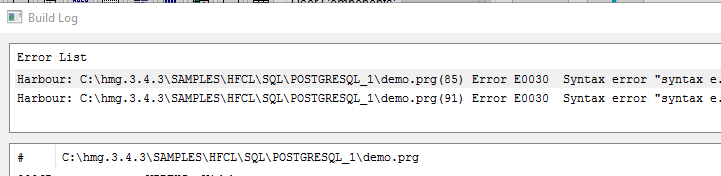

Thank you Serge for your quick reply. The error I'm getting for postgress is;
Harbour 3.2.0dev (r1601151502)
C:\hmg.3.4.3\SAMPLES\HFCL\SQL\POSTGRESQL_1\demo.prg(85) Error E0030 Syntax error "syntax error at '.'"
C:\hmg.3.4.3\SAMPLES\HFCL\SQL\POSTGRESQL_1\demo.prg(91) Error E0030 Syntax error "syntax error at '.'"
2 errors
No code generated.
hbmk2[demo]: Error: Running Harbour compiler (embedded). 1
(C:\hmg.3.4.3\harbour\bin\harbour.exe) -n2 C:\hmg.3.4.3\SAMPLES\HFCL\SQL\POSTGRESQL_1\demo.prg -DHBMK_HAS_HMG32=1 -q -DHBMK_HAS_DEMO=1 -oC:\Users\gkarweru\AppData\Local\Temp\hbmk_1urbk2.dir\ -iC:\hmg.3.4.3\harbour\include -i. -iC:\hmg.3.4.3\include
