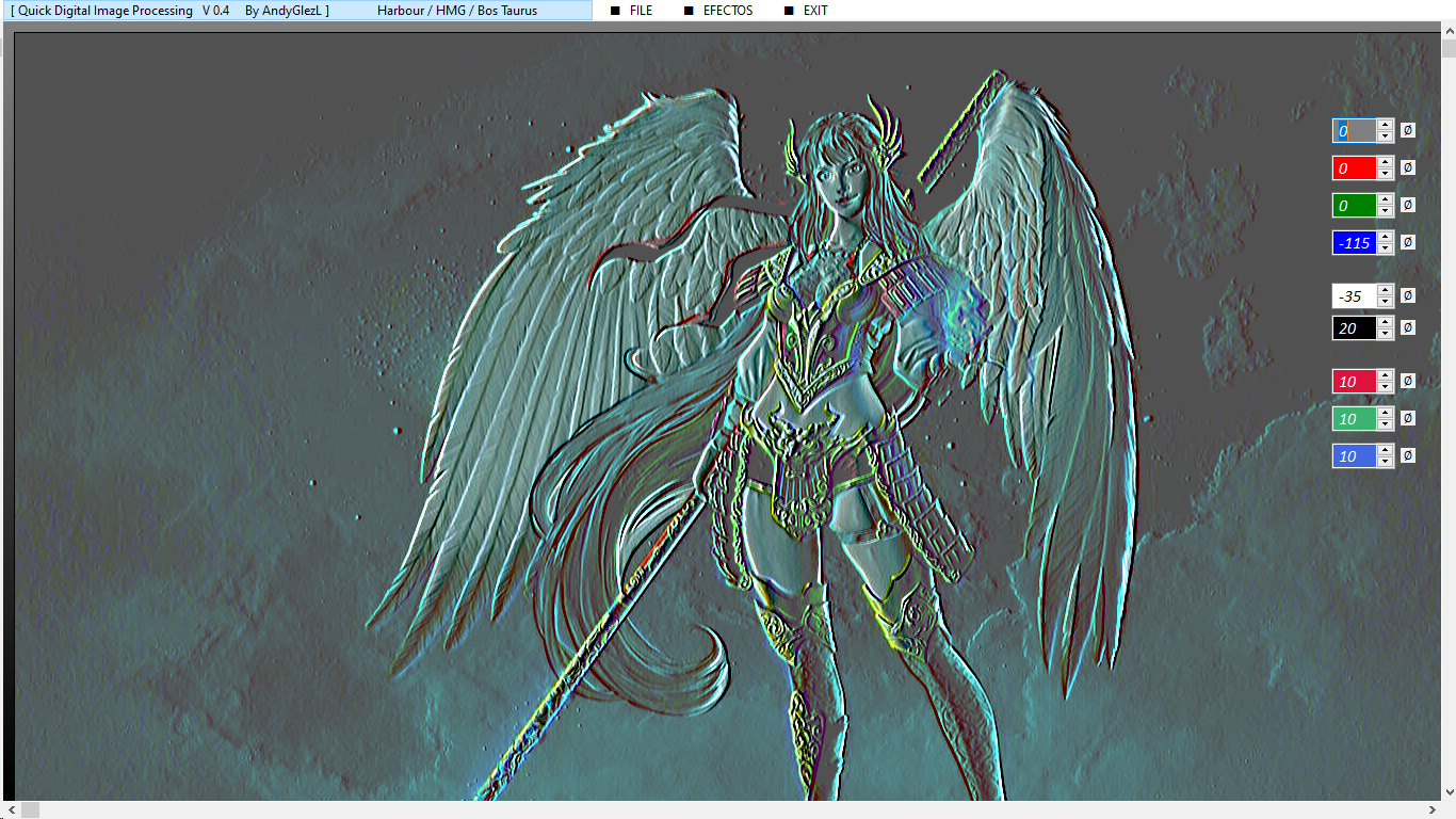

Re: Digital Image Processing
Hola
* Ahora se puede cargar, procesar y salvar una imagen... ( JPG / PNG )
Hi
* Now you can load, process and save an image ... ( JPG / PNG )
* Manejar Brillantes y Contraste...
* Handle Bright and Contrast...
QDIP_AGL.zip
(1.47 MiB) Downloaded 159 times

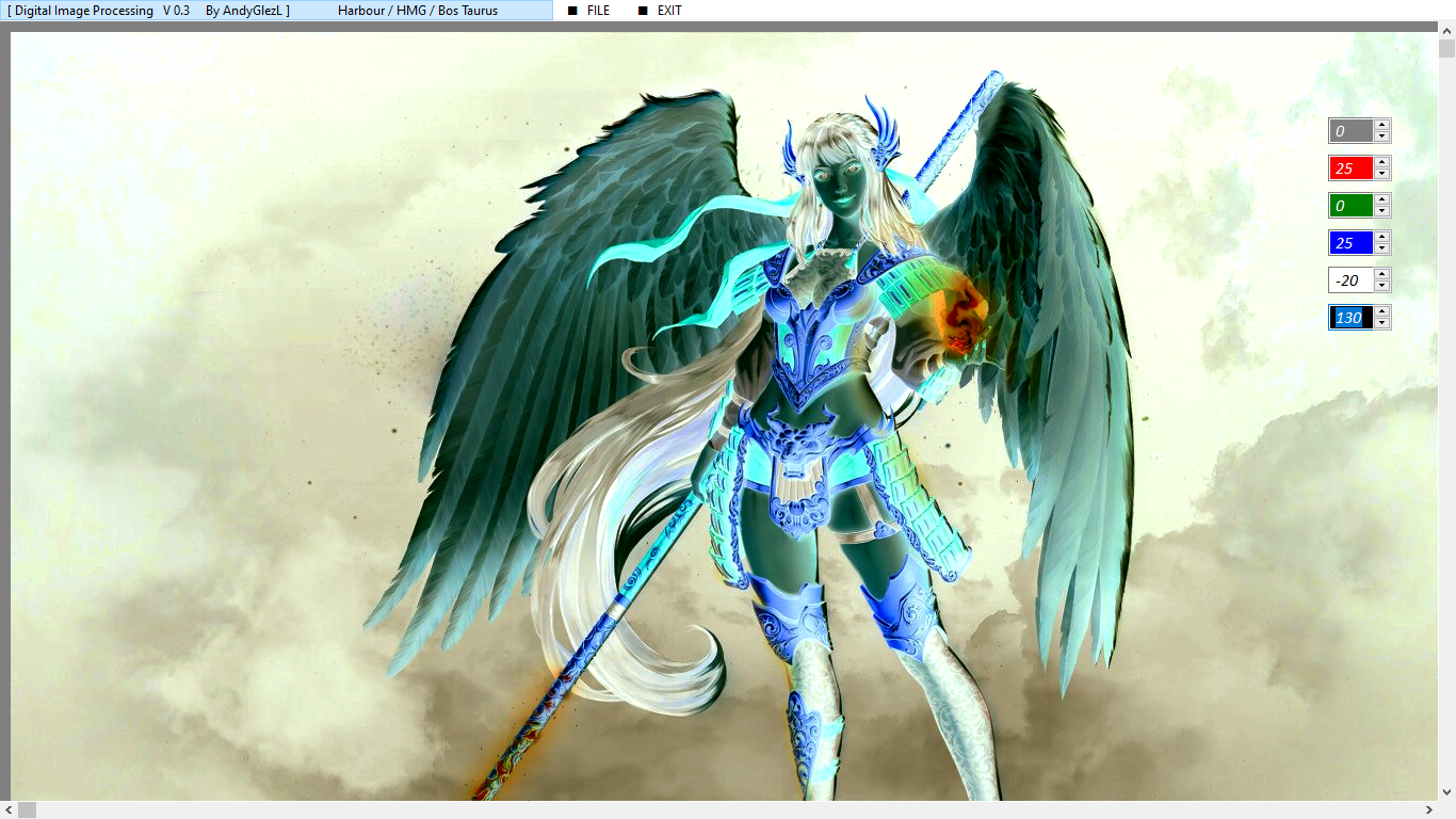

Bueno, parece que me tope con el primer problema...
BT_BitmapGammaCorrect( hBitmap, RedGamma, GreenGamma, BlueGamma )
"RedGamma: is the Gamma Red color level to change (normally range between 0.2 and 5.0, none = 1.0)"
La función BT_BitmapGammaCorrect() maneja valores con decimales y al parecer esto no puede hacerse con los incrementos del control:
@ <nRow> ,<nCol> SPINNER <ControlName> . . . INCREMENT <nIncrement>
Alguna idea de como manejarlo ?
Well, I seem to run into the first problem ...
BT_BitmapGammaCorrect (hBitmap, RedGamma, GreenGamma, BlueGamma)
The BT_BitmapGammaCorrect () function handles values with decimals and apparently this cannot be done with the increments of the control:
@ <nRow>, <nCol> SPINNER <ControlName>. . . INCREMENT <nIncrement>
Any idea how to handle it?
edk
Posts: 999
Post by edk »
andyglezl wrote: Tue Nov 10, 2020 7:32 pm Bueno, parece que me tope con el primer problema...
It's simple: for a spinner control, multiply the allowed value by 10 (min: 2, max: 50, default: 10, increment: 1), and for setting a value for the BT_BitmapGammaCorrect () function, divide it by 10.
e.g. SpinnerRed = 2, SpinnerGreen = 10, SpinnerBlue = 50
BT_BitmapGammaCorrect (hBitmap , SpinnerRed / 10 , SpinnerGreen / 10 , SpinnerBlue / 10) => BT_BitmapGammaCorrect (hBitmap , 0.2 , 1.0 , 5.0)

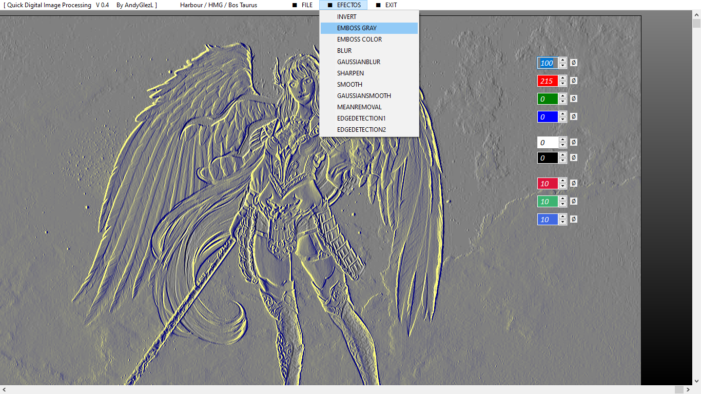

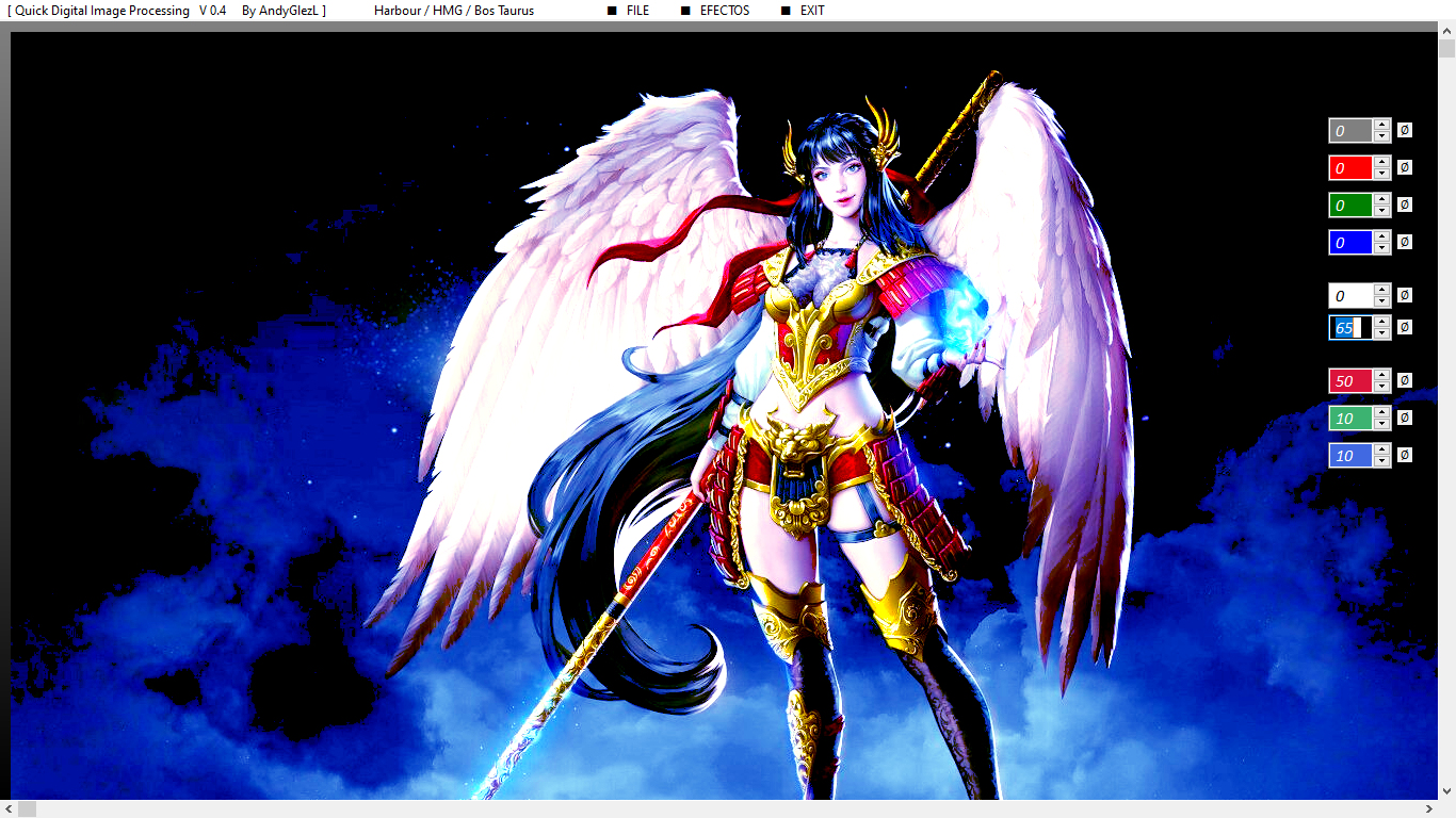

Ahora se puede modificar la Gamma y aplicar varios Efectos...
Now you can modify the Gamma and apply various Effects ...
QDIP_AGL.zip
(1.41 MiB) Downloaded 156 times
Andrés,
Great ! Is it possible to add effect such as 'cartoonize' ?
And ... undo?
