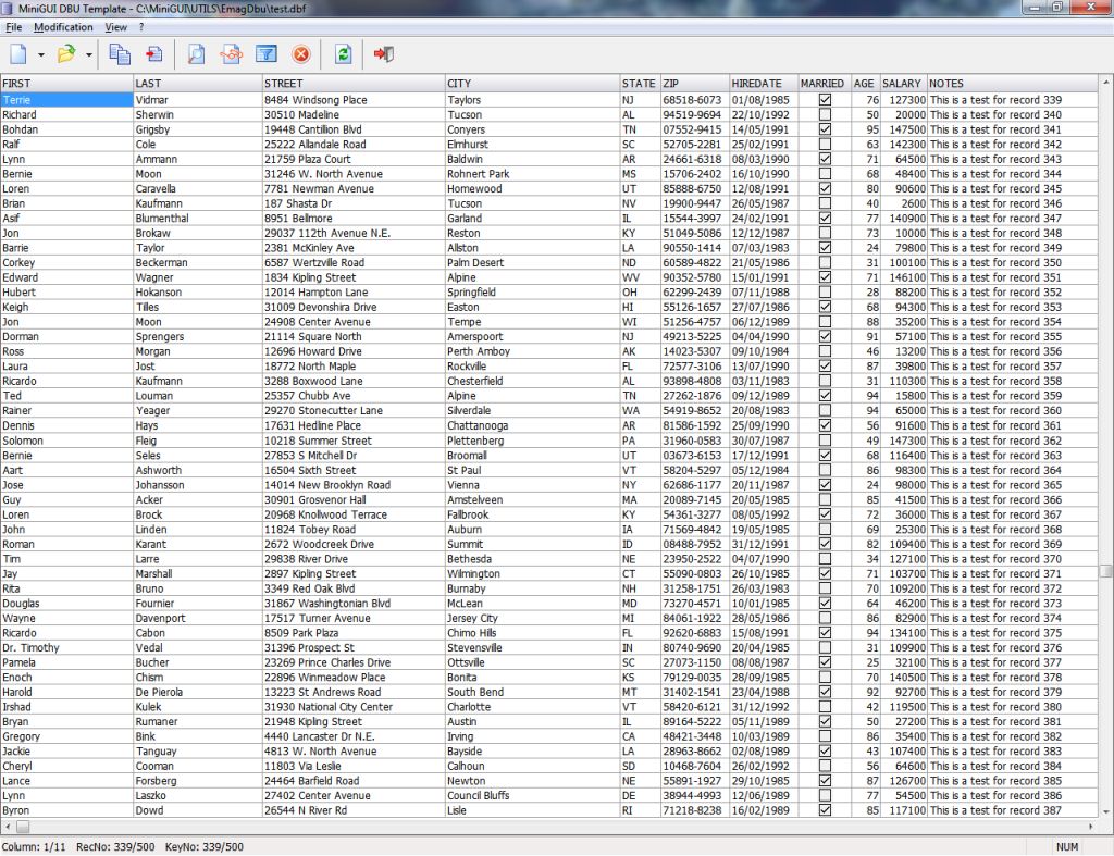

Hi Friends,
I've found a nice utility EMAG Software DBU by Enrico Giordano on Inet.
It was built with FiveWin library and xHarbour compiler.
This DBF Manager works very well but it have an Italian interface only.
The author didn't promise the other localization on the FiveWin forum.
Is it a problem :?:
But we have already the power MiniGUI tool :!:
My humble effort is below. There are the dummy tool buttons and menu actions now.
But it is have a basic TBROWSE features IMHO.

Your feedback is welcome :idea:

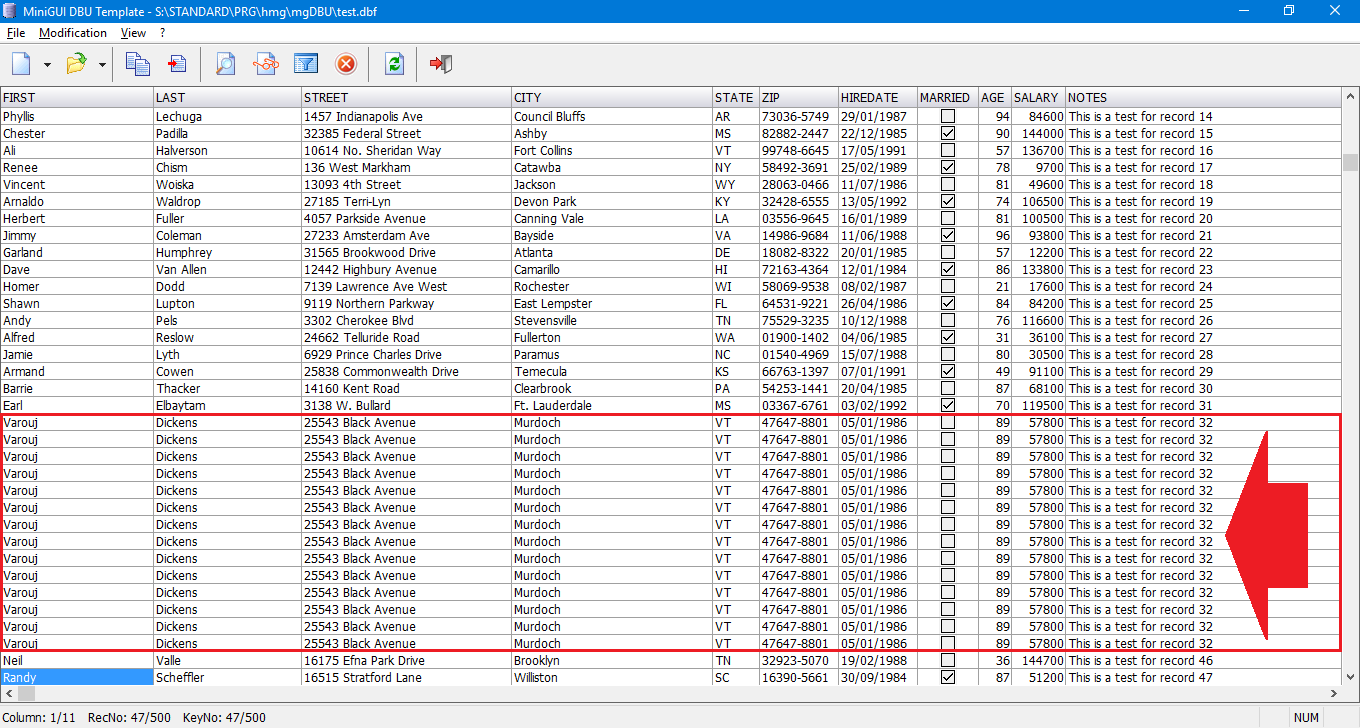

Hello Grigory.
I noticed the strange behavior of TSBROWSE.
If I press and hold down the "cursor down" key and scroll the records, then after reaching the last visible record, the next displayed rows take its value, not the values of physical records.

Hello Edward,
Thanks for yor feedback!
I know that TSBROWSE is not perfect. But it is a best browser for the Minigui now.
Please be so kind to review the updated attached application with the last improvements.
BTW I can not reproduce above wrong behavior in this version 0.64 ;)

Hi again.
gfilatov wrote: Wed Nov 07, 2018 7:36 pm Please be so kind to review the updated attached application with the last improvements.
Small Errat.
It works fine on my home computer, at work: on some computers it's OK, and others are not. I was looking for differences, I compared the OS version, environment settings. In the end I came to the fact that the reason is the resolution of the screen.
I made the test on one computer (Win10 v.1803, 64-bit) and here are the results:
It's correct for resolutions:
1152 x 864
1280 x 600
1280 x 720
1280 x 800
1280 x 960
1280 x 1024
1440 x 1050
1440 x 900
1600 x 900
1680 x 1050
1920 x 1080
Incorrectly at resolutions:
1024 x 768
1280 x 768
1360 x 768
1366 x 768
As you can see, it is incorrect when the screen height is set to 768 pixels.
