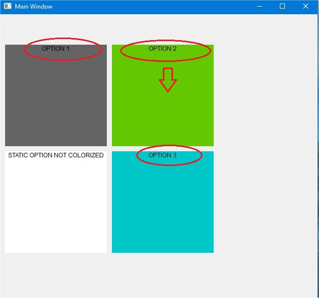

Posts: 1174
Re: Labels and OnMouseHover
Hola amigo Mol:
Felicidades por su aportación
Una pregunta en mi PC Windows 10 Home 64 bits
al compilar me salen la letras en la cabecera
del recuadro.
Como hago para bajarlas más al centro del recuadro.
saludos
Hello friend Mol:
Congratulations on your contribution
A question on my PC Windows 10 Home 64-bit
when compiling I get the letters in the head
of the box.
As I do to lower them closer to the center of the box.
Posts: 3805
Positioning in the middle of label needs modification of hmg h_label.prg and c_label.c library files.
I've duplicated _definelabel funcction to MOL_DefineLabel - sources in attachment.
label_SOURCE.ZIP

Posts: 3805
MOL_DefineLabel("KAFEL3","Form_Main", 220, 270, "My option nr 3", 200, 200,;
						"ARIAL",14, .t., .F., .T.,;
						.f., .f., .f., aLabelColors [ "KAFEL3" ], {64,64,64},;
						NIL,"kafel 3",NIL, .f., .f.,;
						.f., .f., .f. , .F. , .t. ,;
						.f.,.F.,.T.)
Last parameter causes center vertical alignment.
It's important - label defined with center vertical alignment does not supports word wrapping.
