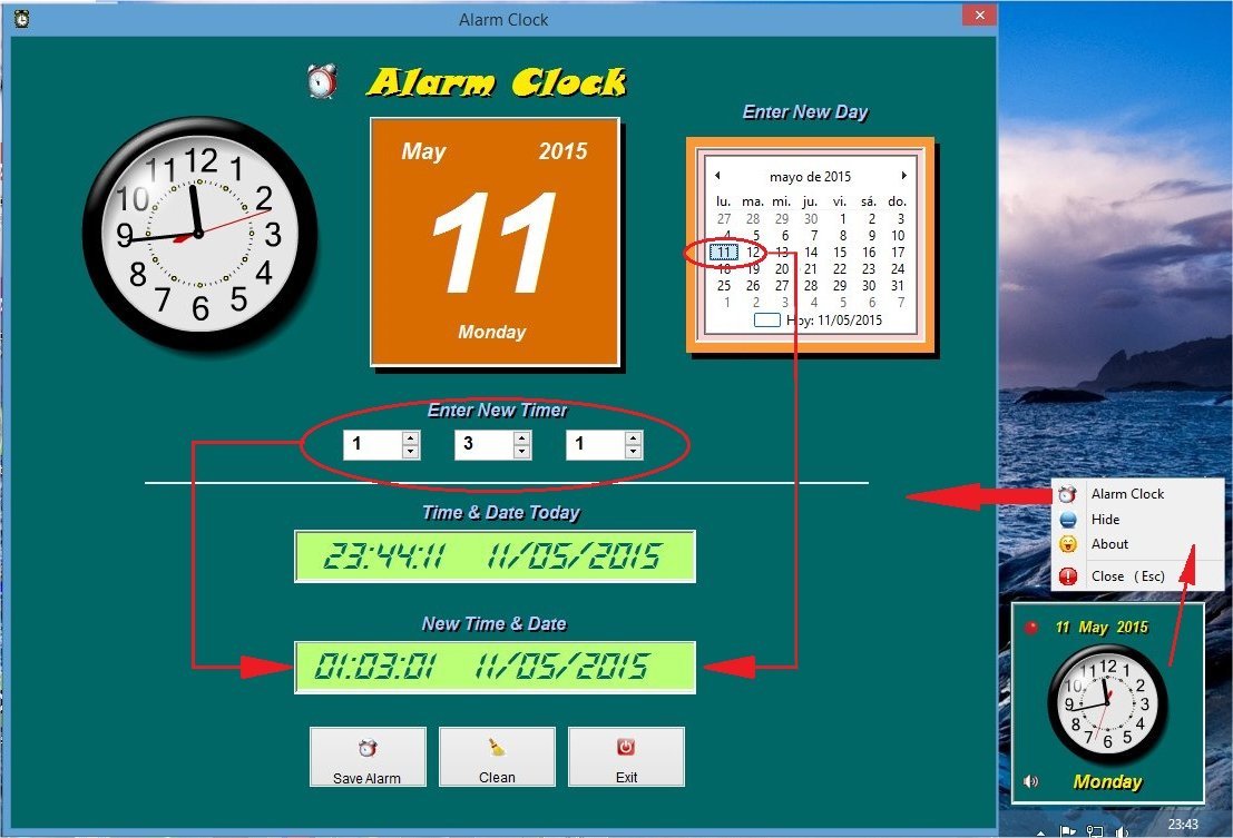

Hola amigos
Les presento un pequeño Sample de
un Reloj Despertador con la convinación del fichero
"clock82.swf" que creo que aporta un toque muy estético.
Miren el fichero "Readme.txt" y "Resource\screenshot.jpg"
Un saludo

Hello friends
I present a small Sample of
an Alarm Clock with convinación file
"clock82.swf" I think it gives a very aesthetic touch.
Look at the "Readme.txt" file and "Resource\screenshot.jpg"
greetings
Mustafa ;)

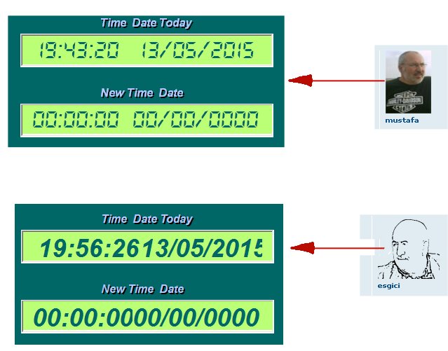

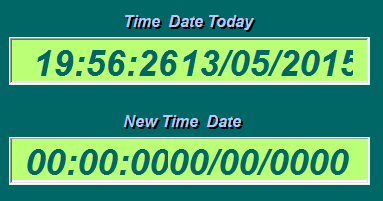

Does everybody is in 64 Bit :?
This program too has TOPMOST problem when built in 32 bit (It's impossible to reach to CONTEXT menu) :cry:
Maybe the TOPMOST problem is for 32 bit environment only :?
Regards to developers :mrgreen:
Added later :
More, I couldn't see "digital" digits :(

Hola amigo Esgici
Mire el pantallazo que le mando
La diferencia creo que está en la falta de instalar las Fonts
DS-DIGIT.TTF que estan en Carpeta Fonts cualquiera de las
cuatro que hay en carpeta.
Ver fichero build.log

Hello friend Esgici
Look at the screenshot to control it
I think the difference is the lack of install the Fonts
DS-DIGIT.TTF who are in any of the Fonts folder
four is in store.
View file build.log

Re: Alarm Clock
four is in store.
OK Brother,
Font problem eliminated after installed font files (DS*.TFF) to Windows\Fonts folder.
Sorry, I expected fonts became usable without installed :oops:
And .exe you sent worked fine ( without TOPMOST problem ) :o
I didn't understand why ? :?
Anyway thanks to share :arrow:
Saludos cordiales :D
Added later :
Now, clear : HMG 3.2 not have TOPMOST problem :arrow:

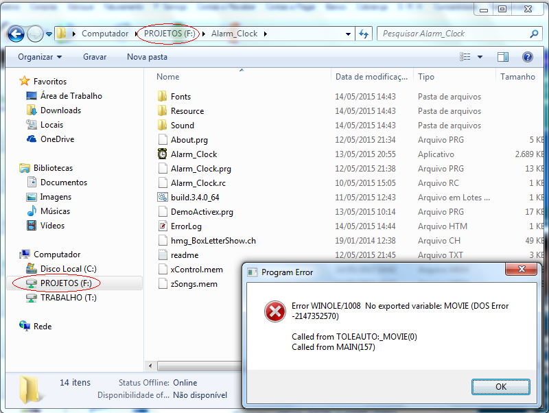

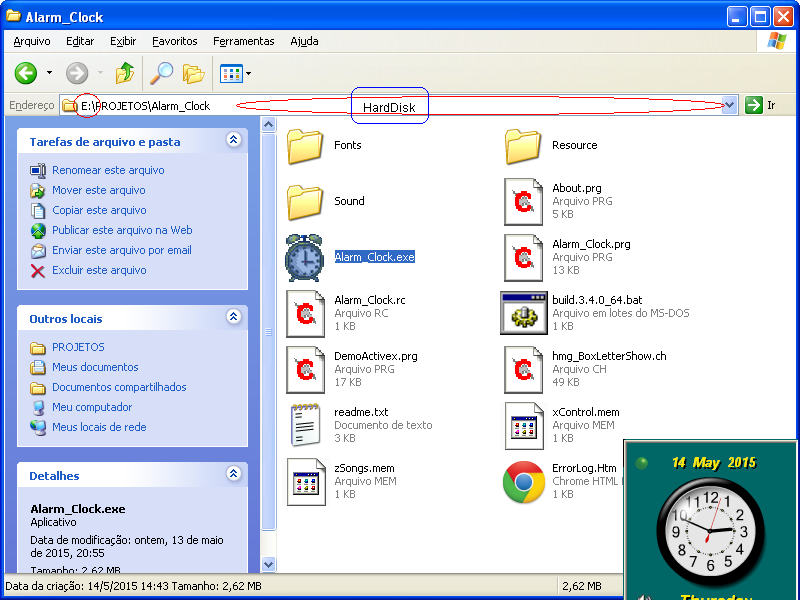

Good afternoon, ran the example on a secondary HD [E:] installed on a machine with Win / XP, rolled perfect image alarm1.png. As the folder is shared with a colleague who requested access to the program to see its operation, and the error occurred the alarm.png image with Win / 7 Ultimate.
