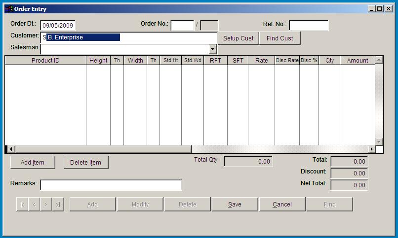

Hi Esgici & Rathi,
Thanks a lot. Excellent utility!!! :)
Only one suggestion:
When typing in the textbox if right side of the cursor position is automatically selected, then it will be better for user (I did the same thing in one of my VFP utilities, as suggested by one of my clients)
With best regards.
Sudip

Now, I want to explain what I mean with the help from my old app ... :)
This is HMG forum, but I want to share some of my old codes written in another software tool to mean what I want to say.

frmFind is a form with listbox for searching records.
Above code is not generic and I never used that code later. :(
Thank you again for sharing this code. I am very happy with this team work :)
