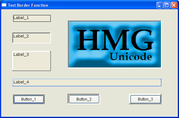

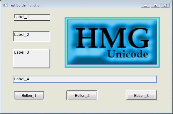

Hi All
Almost every control has their own border, except a few ones, like Label and image.
This is an humble work to search an easy way to draw a border around controls.
To your interest, critics and suggestions.
Screen shoot of Test Draw Border prg
Screen shoot of test DrawBorder.png (153.72 KiB) Viewed 8891 times
TestBorder.zip
Source files for Test Draw Border prg
(66.13 KiB) Downloaded 584 times
By the way, I have a problem; please look at TestBorder.prg line 54-55;
will be appreciated your advice.

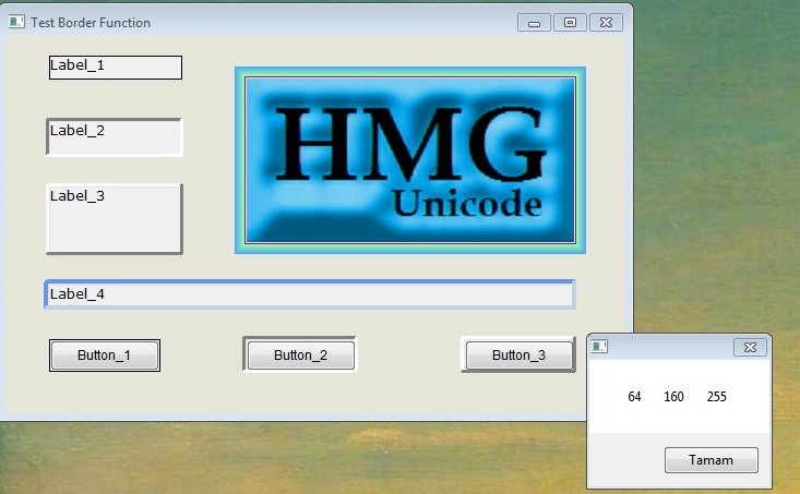

serge_girard wrote: Try msgbox with str(aColor [1]) + ' ' + str(aColor [2]) + ' ' + str(aColor [3]).
This should help !
Thank to your interest and suggestion :)
I'm afraid that I couldn't tell :(
Problem isn't about Message function ( MsgDebug() is very good enhancement, thank to Dr. Soto ).
Problem is in border of image.
Please look at below image: while MsgDebug() is in screen, border seen fine,
Image border if message in it place

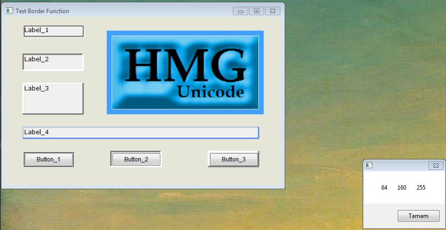

when Msg gone ( or replaced ) the border changes :(
Image border after message replaced
PS: don't look border of Label_4; this image is a bit older.
Draw border
Nice work Esgici, I liked !
As you said, the main problem is not based on Msg functions at all (it's my tip too). Even if you do not use msg function and minimize the main window, you will see border will be also changed. I believe it an tipic behaviour of API of OS and probably there is not solution for this... :(
But I find a way to put borders around IMAGEs:
I put an extra label with same size and position of IMAGE. This could it be not the best practice but could helps until get better solution.
