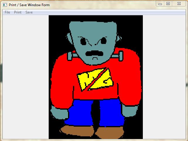

Here slightly modified to working version of orijinal program:
Result:
Source:
PrintFormSource.zip
(48.45 KiB) Downloaded 660 times
Executable:
PrintFormExe.zip
(1.51 MiB) Downloaded 653 times
