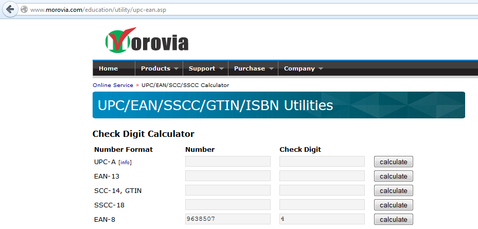

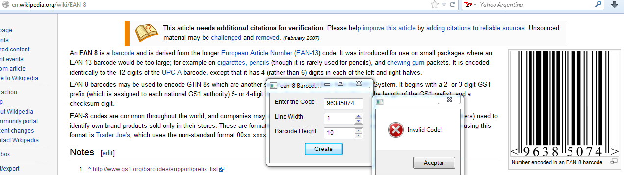

Code 96385074 Fail.
Windows 7 Home Premiun, HMG.3.1.4
compiled with Mibuil.bat
barean8.rar
(3.01 KiB) Downloaded 2061 times
Webpage check code
Wikipedia number example

That is very odd. The message 'Invalid Code!' is given for codes having length < 7 or > 8. Therefore, please verify the length of the code (is there any space?).
It works fine for me.
