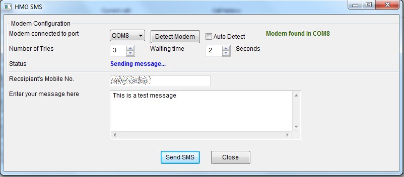

One of my clients had asked for SMS sending feature in HMG software.
I have connected GSM modem using COM port connection and created a SMS utility in HMG. I used the concept from hbcomm and hbsms contrib.
Hope this will be useful for others too.
sms.zip
(4.84 KiB) Downloaded 747 times
