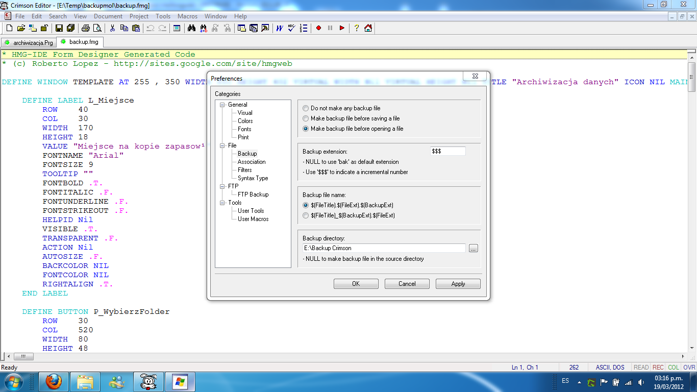

Posts: 2646
Re: simple backup program
Hi Mol:
appreciate your contribution.
in my case I use the backup of Crimson Editor.
is also incremental.
also open the FMG, so when I change the FMG with the IDE takes modificacions Crimson editor and writes well in an incremental manner.
