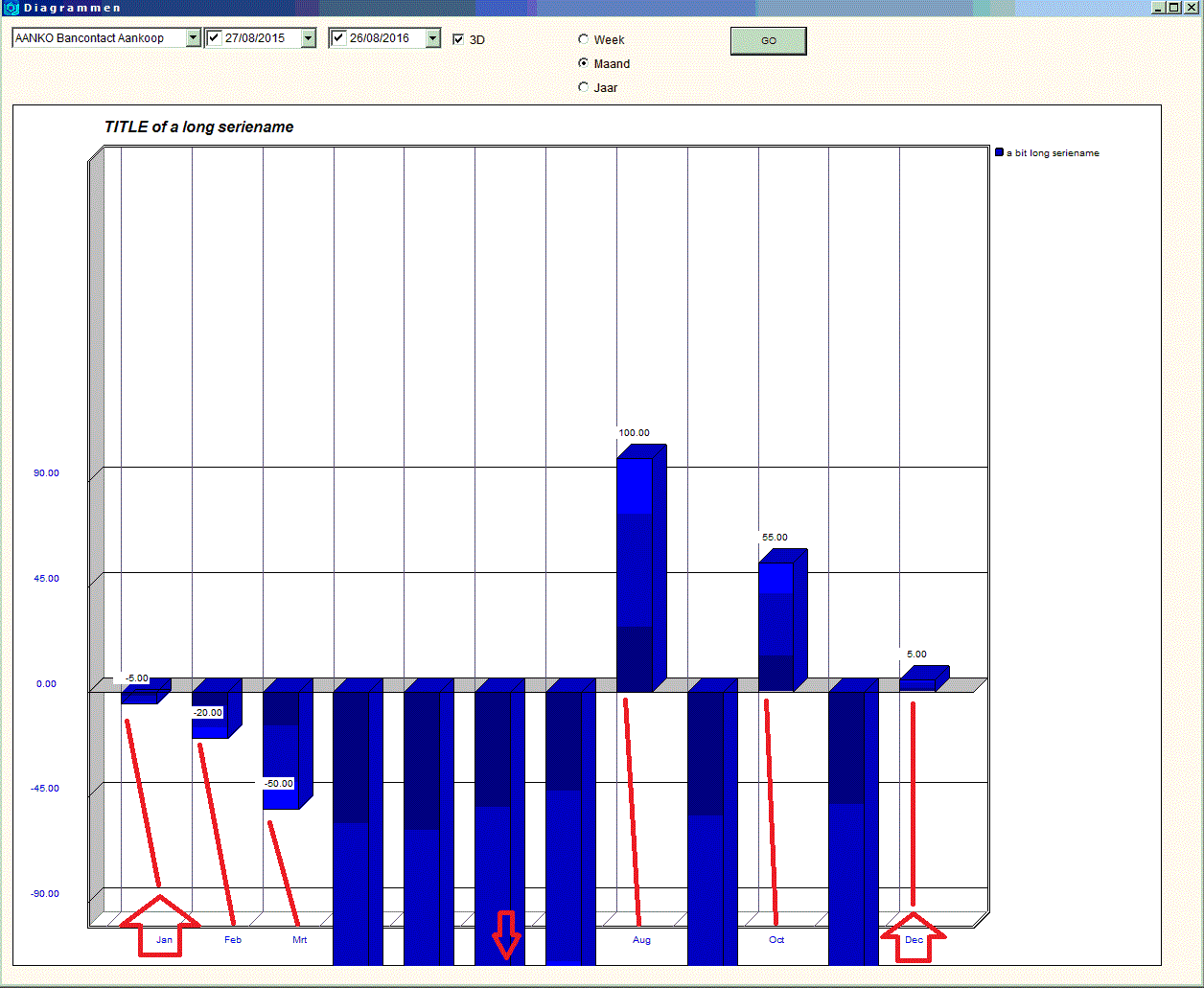

Claudio or Rathi,
I made a simple BAR graph and found 2 minor problems:
- using a value range of -200 to 200 the division of the values is not correct and the highest negative bars fall out of the picture.
- the leftmost SERIEYNAMES is positioned at the right; last occurence of SERIEYNAMES is correct.
Greetings,
aSer	      := ARRAY(1, 12 )
aVal			:= ARRAY(12)
aSERIE	   := ARRAY(1)
aCOL			:= ARRAY(1)
aCOL [1]		:= BLUE
aSERIE [1]  := 'a bit long seriename'
aSer	[1,  1] :=   -5
aSer	[1,  2] :=   -20
aSer	[1,  3] :=   -50
aSer	[1,  4] :=   -200
aSer	[1,  5] :=   -210
aSer	[1,  6] :=   -175
aSer	[1,  7] :=   -150
aSer	[1,  8] :=    100
aSer	[1,  9] :=   -188
aSer	[1, 10] :=   55
aSer	[1, 11] :=   -170
aSer	[1, 12] :=   5
aVal	[1] :=   'Jan'
aVal	[2] :=   'Feb'
aVal	[3] :=   'Mrt'
aVal	[4] :=   'Apr'
aVal	[5] :=   'May'
aVal	[6] :=   'Jun'
aVal	[7] :=   'Jul'
aVal	[8] :=   'Aug'
aVal	[9] :=   'Sep'
aVal	[10] :=   'Oct'
aVal	[11] :=   'Nov'
aVal	[12] :=   'Dec'
GRAPH BITMAP   BARS ;          // Form_1.GraphType.VALUE ;  // constants: BARS = 1, LINES = 2, POINTS = 3 are defined in i_graph.ch
   SIZE        1200, 900 ;
   SERIEVALUES aSer ;
   SERIENAMES  aSERIE ;
   SERIECOLORS aCOL ;
   SERIEYNAMES aVal ;
   PICTURE     "99,999.99" ;
   TITLE       'TITLE of a long seriename' ;
   TITLECOLOR  BLACK ;
   HVALUES     5 ;
   BARDEPTH    15 ;
   BARWIDTH    15 ;
   SEPARATION  0 ;
   LEGENDWIDTH 150 ;
   3DVIEW      .T. ;
   SHOWGRID    .T. ;
   SHOWXGRID   .T. ;
   SHOWYGRID   .T. ;
   SHOWVALUES  .T. ;
   SHOWXVALUES .T. ;
   SHOWYVALUES .T. ;
   SHOWLEGENDS .T. ;
   NOBORDER    .F. ;
   STOREIN     hBitmap
Form_DIAGRAM.Image_1.HBITMAP := hBitmap   // Assign hBitmap to the IMAGE control
Posts: 5481
Re: HMG Graph based on Bas Taurus
I will see to it Serge.

I'm quoting this post from over the year ago.
I'm using Rathi's graph solution for generating bar graphs. After few regenerating graph, My app does strange screen effects. I've modified a little original code, so, I thought this is my error.
But, I'm testing original code, and after few changes, this sample works bad, too.
Try to compile this sample ang change only bar type until your graph dissappear.
Where is the error? Can sb. test it?
In my opinion, i tcan be Bos Taurus library problem...
