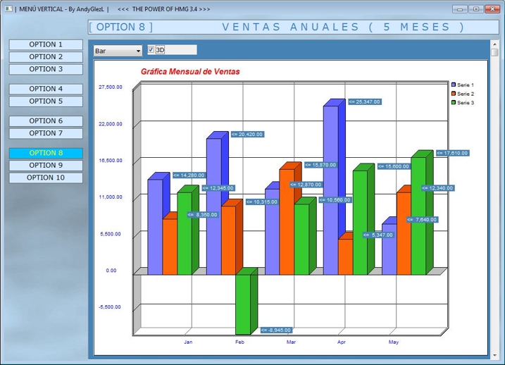

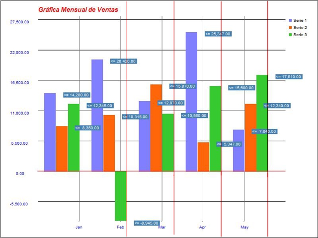

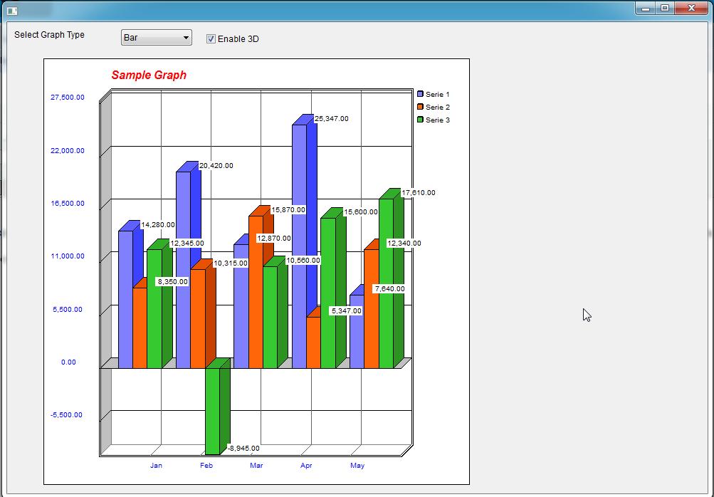

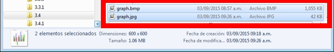

Hi friends,
Now, we can save/show HMG Graphs (BARS/LINES/POINTS/PIE with 3D also) in bitmap format. I have reused the h_graph.prg and c_graph.c code according to Bas Taurus. I think this can be included ( after rigorous testing ) in our HMG Code.
Claudio, this code contains code for drawing polygons, Polybeziers, arcs and pie. I think you can use them in the next version of Bas Taurus.
   define window graph at 0, 0 width 1000 height 700 main
      define label selecttype
         row 10
         col 10
         width 150
         value 'Select Graph Type'
      end label
      define combobox graphtype
         row 10
         col 160
         width 100
         items { 'Bar', 'Lines', 'Points', 'Pie' }
         onchange drawgraph()
      end combobox
      define checkbox enable3d
         row 10
         col 280
         width 100
         caption 'Enable 3D'
      end checkbox
      define image grapharea
         row 50
         col 50
         width 600
         height 600
      end image
   end window
   graph.graphtype.value := 1
   graph.center
   graph.activate

Re: HMG Graph based on Bas Taurus
Cambiando la linea que dice:
BT_BitmapSaveFile(hBitmap, cImageFileName )
por:
BT_BitmapSaveFile(hBitmap, cImageFileName, BT_FILEFORMAT_JPG )
Changing the line that says:
BT_BitmapSaveFile (hBitmap, cImageFileName)
by:
BT_BitmapSaveFile (hBitmap, cImageFileName, BT_FILEFORMAT_JPG)
Posts: 5481
Thank you Andy. Sometimes, compression spoils the image quality. We can use jpg as default.
Hola Rathinagiri
Cual linea se modifica, para las lineas que separan los titulos de meses,
creo que deberian de estar donde pongo la linea roja...
Hello Rathinagiri
Which line is changed to the lines that separate the titles of months,
I think they should be put where the red line ...
Fabuloso Rathinagiri !
Solo me falta ver como ajusto mas a la izquierda las etiquetas de valores
para que queden sobre la barra correspondiente.
Fabulous Rathinagiri !
I only need to see how I adjust the leftmost value labels
so that they are on the corresponding bar.
Posts: 2223
Rathinagiri wrote:Hi friends,
         row 10
         col 10
         width 150
      end label
         row 10
         col 160
         width 100
      end combobox
         row 10
         col 280
         width 100
         caption 'Enable 3D'
      end checkbox
         row 50
         col 50
         width 600
         height 600
      end image
   end window
   graph.center
   graph.activate
function drawgraph
   local cImage := 'graph.bmp'
   local nImageWidth := 600
   local nImageHeight := 600
   local cTitle := 'Sample Graph'
   local aYValues := {"Jan","Feb","Mar","Apr","May"}
   local aData := { {14280,20420,12870,25347, 7640},;
           { 8350,10315,15870, 5347,12340},;
           {12345, -8945,10560,15600,17610} }
   local nBarDepth := 15
   local nBarWidth := 15
   local nHValues := 5
   local l3D := graph.enable3D.value
   local lGrid := .t.
   local lXGrid := .t.
   local lYGrid := .t.
   local lXVal := .t.
   local lYVal := .t.
   local nGraphType := graph.graphtype.value
   local lViewVal := .t.
   local lLegends := .t.
   local cPicture := '99,999.99'
   local aSeries := {"Serie 1","Serie 2","Serie 3"}
   local aColors := { {128,128,255}, {255,102, 10}, {55,201, 48} }
   local lNoBorder := .f.
   local nLegendWidth := 50
   if graph.graphtype.value == 0
      return nil
   if graph.graphtype.value == 4 // pie
      drawpiegraphinBitMap( cImage, nImageWidth, nImageHeight, {1500,1800,200,500,800}, {"Product 1","Product 2","Product 3","Product 4","Product 5"}, {{255,0,0},{0,0,255},{255,255,0},{0,255,0},{255,128,64},{128,0,128}}, "Sales", 25, l3D, lxval, lLegends, lnoborder )
      graphsave( cImage, nImageWidth, nImageHeight, aData,  cTitle, aYValues, nBarDepth, nBarWidth, nil, nHValues, l3d, lGrid, lXGrid, lYGrid, ;
               lXVal, lYVal, lLegends, aSeries, aColors, nGraphType, lViewVal, cPicture, nLegendWidth ,lNoBorder )
   graph.grapharea.picture := 'graph.bmp'
   return nil
