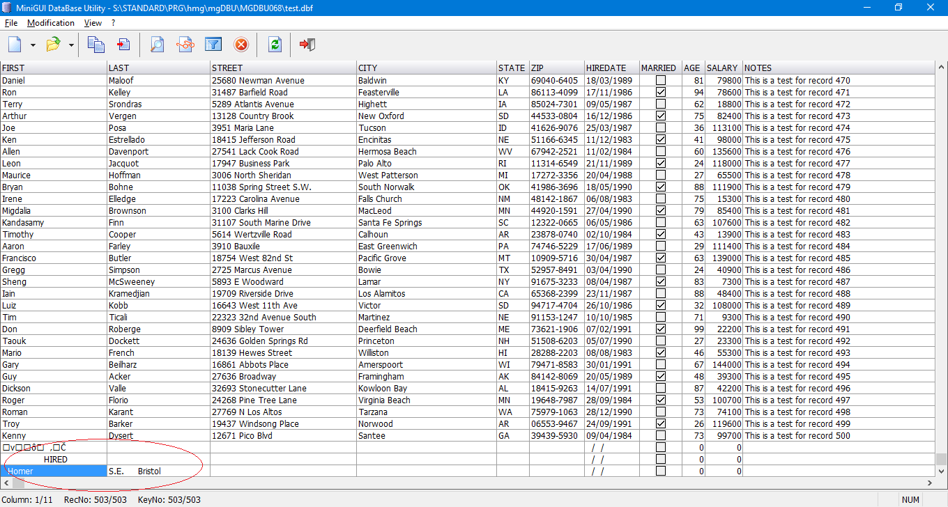

Hi Grigory.
Thx for new version.
Another issue:
Try to:
1. Copy a table test.dbf (without condition)
2. Import a record from the file you copied (without condition)
3. Press END key
Bez tytułu.png (117.03 KiB) Viewed 7031 times

edk wrote: Wed Nov 14, 2018 2:00 pm Hi Grigory.
Another issue:
Try to:
3. Press END key
Hi Edward,
Thanks for your bug report :!:
It was my mistake at an import of the records :(
This bug was fixed already and I've attached the updated application for your further testing.
