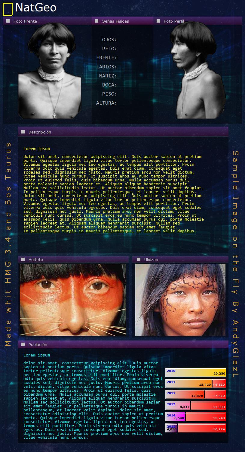

Bueno, despues de muchos dias de desvelo, les muestro lo que logré hacer con
HMG 3.4 y Bos Taurus.
Well, after many sleepless days, I show you what I got to do with
HMG 3.4 and Bos Taurus.

Wow! Looks so professional. The horizontal bar graph is so good! I like it a lot.
Re: HMG Graph based on Bas Taurus
Gracias Rathinagiri
Bueno, tal vez tu puedas integrarlo al gran trabajo que has hecho con Graficas y Bos Taurus
Thanks Rathinagiri
Well, maybe you can integrate the great work you've done with Bos Taurus and Graphics
