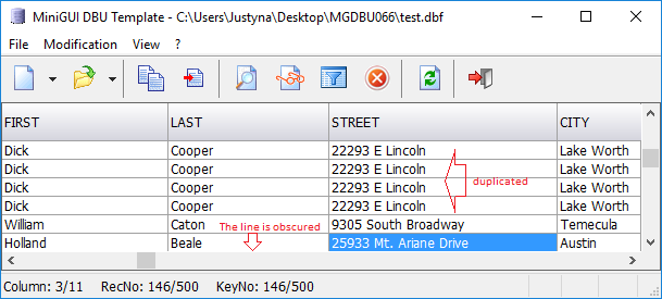

I did some more tests. They show that the problem occurs when the window size is set to such a height that the horizontal slider obscures the line separating the rows. I do not know if you understand me well, because my English is not the best, so I will try to present it with screenshots.
At this window height the scrolling is correct. And at this height, the records are duplicated during scrolling. The difference between windows is 1 px in height.

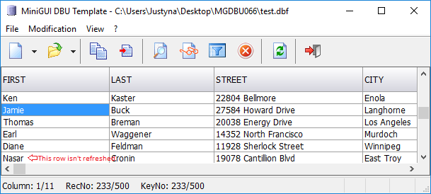

If we still reduce the window height by another 1 px, then they are not duplicated, but the last line (the incomplete height) is not refreshed. Can you confirm it and report it to the TsBrowse authors?

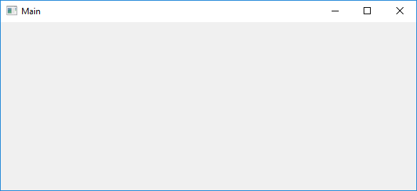

By the way, I noticed one more curiosity: the size of the window that I define in HMG does not correspond to the size of the window on the screen (the size read from the capture of the screenshot)
The size of 600 x 275 px is defined in the sources:
and the screenshot is made in the size of 586 x 268 px. (difference in dpi?)
FUNCTION Main()
DEFINE WINDOW Form1 AT 0 , 0 WIDTH 600 HEIGHT 275 TITLE 'Main' MAIN
CENTER WINDOW Form1
ACTIVATE WINDOW Form1
Return NilRe: MiniGUI DBU
Hi Edward,edk wrote: ↑Fri Nov 09, 2018 10:07 pm Hey,
thanks for your patience.
After changing the height of the grid header is now OK for the window height 768 px.
Thanks for your tests and explanation.
It is a known problem in the TsBrowse library but it is not critical.
The simple workaround is a placing of the TBrowse object into a window with the NOSIZE style.
