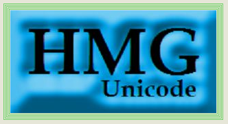

Hi All
Another implementation of "Wide Border":
Screen shoot of Wide Border - 1
TestBorder2.prg.zip
Modified prg for wide order
(794 Bytes) Downloaded 373 times

esgici wrote:By the way, I have a problem; please look at TestBorder.prg line 54-55;
will be appreciated your advice.
Hi Friend,
The DrawLine command runs a codeblock and the problem is when passing the array parameter to the codeblock.
See this fixed code:
PROCEDURE DrawWideBorder( ;
                     cWindowName,;
					 cControlName,;
					 aColor,;
					 nSpace,;
					 nStep )
	LOCAL nWidness, cColor
	HB_DEFAULT( @nSpace, 10 )
	HB_DEFAULT( @nStep, 1 )
	FOR nWidness := 1 TO nSpace STEP nStep
      cColor := "{"+hb_ntos(aColor[ 1 ])+","+hb_ntos(aColor[ 2 ])+","+hb_ntos(aColor[ 3 ])+"}"
      DRAW BORDER WINDOW cWindowName CONTROL cControlName UPCOLOR &cColor DOWNCOLOR &cColor SPACE nWidness
	   aColor[ 1 ]  -= 10
	   aColor[ 2 ]  -= 10
	   aColor[ 3 ]  += 10
    NEXT nWidness
RETURN  // DrawWideBorder()

srvet_claudio wrote: The DrawLine command runs a codeblock and the problem is when passing the array parameter to the codeblock.
Thank you very much Hidalgo :)
I'll try
Best regards :D
Re: Draw border
esgici wrote: I'll try
Hats to the air :shock:
Extremely appreciated dr. :arrow:
You are a true life-saving hidalgo 8-)
