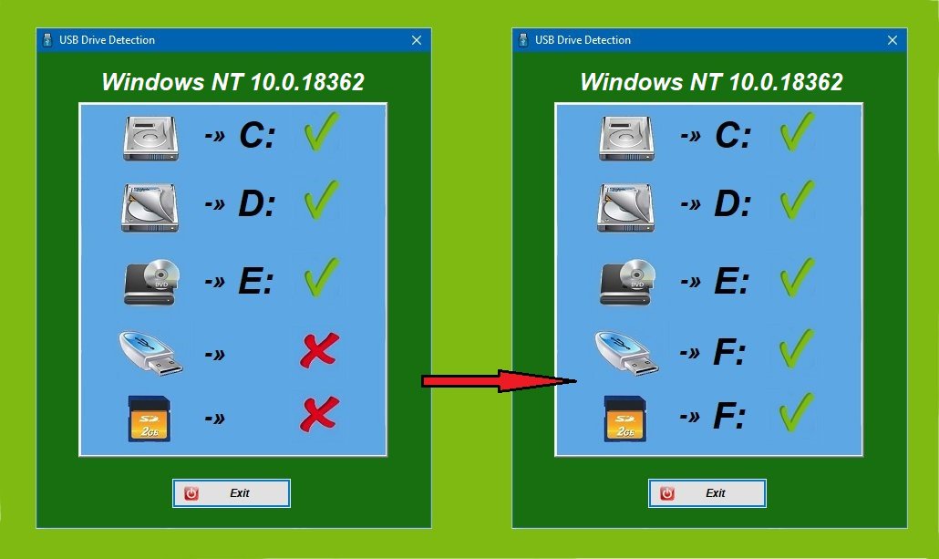

Posts: 1174
Re: Detect Pendrives connected
Hola amigos
Aqui teneis una nueva muestra de detección
USB-Pendrive , en mi Ordenador me están saliendo
las unidades que en esta muestra os presento
Me esta detectando la Tarjeta de Memoria como Letra F:
igual que la Unidad Usb y puedo mandar ficheros Zip Back-up
A través de mi sample "USB-PenDrive.exe" sin ningún
problema.
*---------------------------- Google ---------------------------*
Hello friends
Here you have a new detection sample
USB-Pendrive, on my Computer they are coming out
the units that in this sample I present to you
The Memory Card is being detected as Letter F:
same as Usb PenDrive and I can send Zip Back-up files
Through my sample "USB-PenDrive.exe" without any
problem.
USB-Detect2.zip
(131.51 KiB) Downloaded 177 times

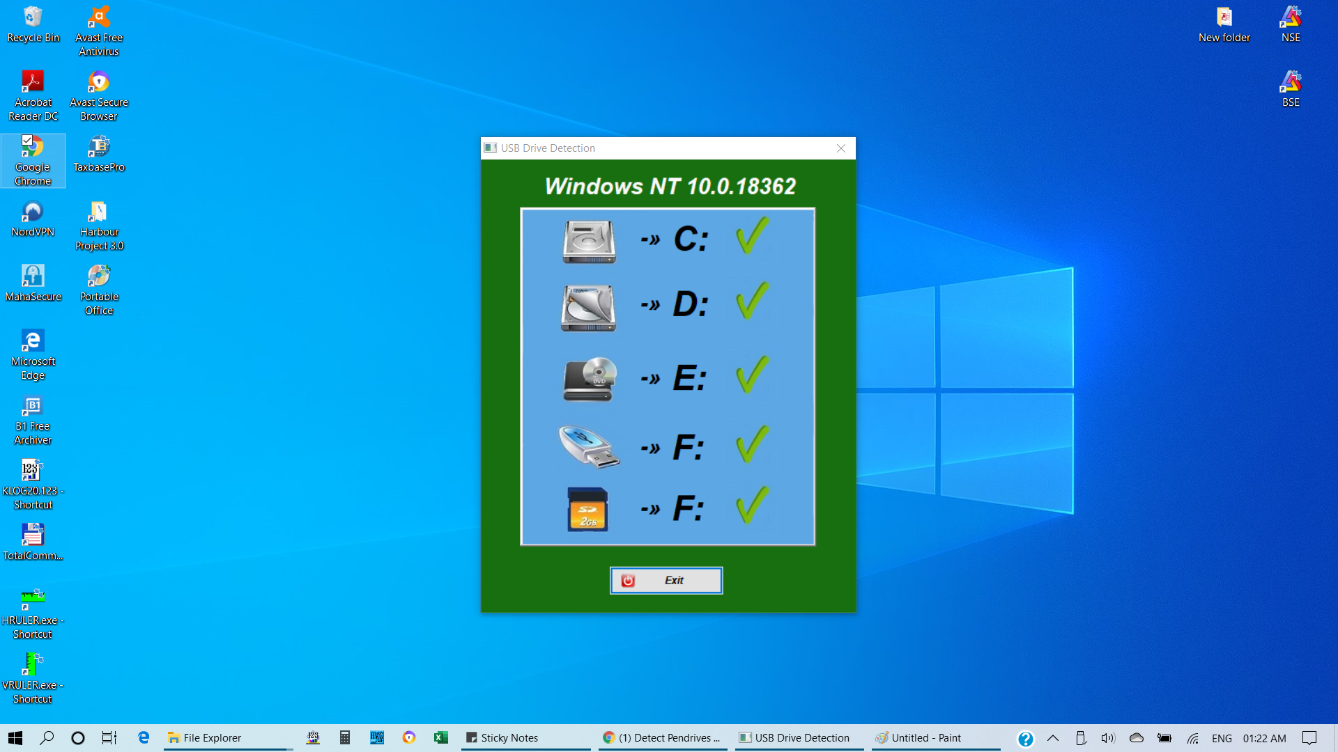

RPC
Posts: 308
Post by RPC »
Hi Mustafa
USB_Detect2 works.
It shows both the pen drive and also external HDD when connected.
Many thanks
Posts: 1174
Hello friend RPC
In my sample how it is marking the attached screenshot
I am marking the Hard Disk C: and D: DVD E: and the
USB-Pendrive as F: and Memory Card also as
letter F:
In your case, which Unit letters do you get? the
External Hard Drive also as letter F:?
Greetings
RPC
Posts: 308
Post by RPC »
Hi Mustafa
I have partitioned my HDD as C:,D: and E: so I get follo SS when I attach external HDD or pendrive
