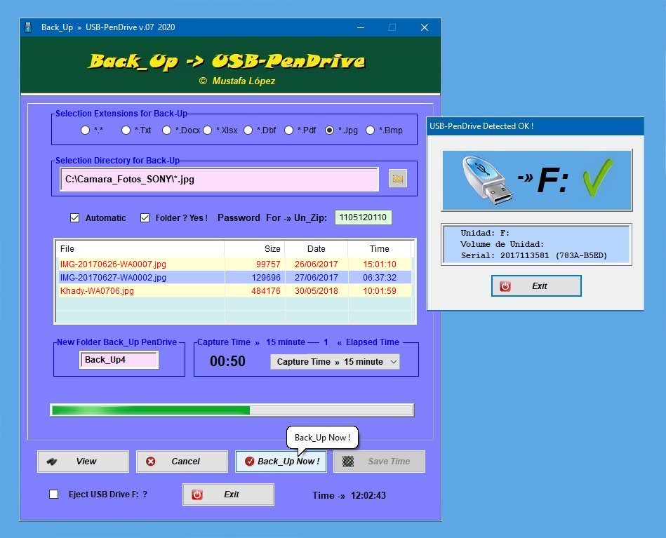

Hello friends:
By text capability, it is published only
in English, you have the translation in Spanish
in file "Readme.txt"
I've been experiencing watching for a while
BackUp works with USB-PenDrive
http://hmgforum.com/viewtopic.php?f=9&t=2174
viewtopic.php?f=5&t=4524&hilit=cDriveLetter
This Sample creates Zip files with an option to Password
and Folder we can't do with Compress
See my post of Nov 26, 2018
viewtopic.php?f=8&t=5864&p=57940&hilit= ... ile#p57940
Decrypt_Tools Files Zip is also attached to be able to decode the
Zip files (See demos)
Description:
Extension Selection for Back_Up and Select the Directory where
are the files to make the ZIP
We mark Manual or Automatic if we want Password and if the Zip includes Folders?
The files selected for the New Zip will appear in a Grid
We choose Folder for USB-Pendrive Drive to do Back-UP and indicate the
time in minutes it will take us to do the Back-up from 1 minute to 60 minutes
We do [Save Time] and start the countdown and if we prefer Back-Up
instant, press [Back_Up Now!]
In option [View] we have Grid that indicates all the positions of the Zip copy
Delete all the DataBase or Delete some record and a list of the DataBase.
Pressing [Exit] will not leave a Message that indicates that if we want to disconnect
the PenDrive of our computer, if you indicate If it disconnects but I am running
The PenDrive with the Light on but Win-10 indicates that there is no F Unit:
PS: I don't know how to hold the USB-PenDrive Drive Letter, the Sample is
Based on my Computer that the Unit is F:

- PenDrive_BackUp_v07.zip
- (3.17 MiB) Downloaded 236 times
- Pantallazo.jpg (115.6 KiB) Viewed 3992 times

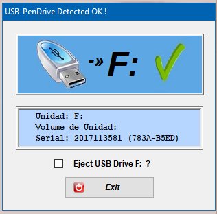

- Usb_Detect.zip
- (66.2 KiB) Downloaded 242 times
- Pantallazo.jpg (22.37 KiB) Viewed 3960 times

Re: Detect Pendrives connected
Hola Jimmy
No se como intrepretar el código de su escrito
podria poner un pequeño sample completo solo
referente a la detección de unidades USB PenDrive
