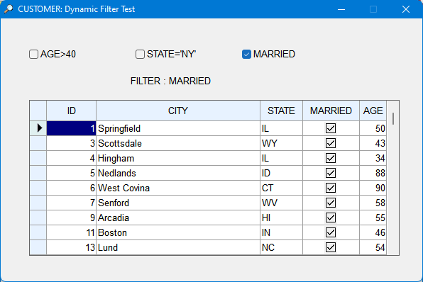

The original form with the TBROWSE control, three checkboxes and a filter status is shown below. :arrow:
Then we set a filter on MARRIED field

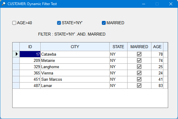

Add the filter condition on STATE field

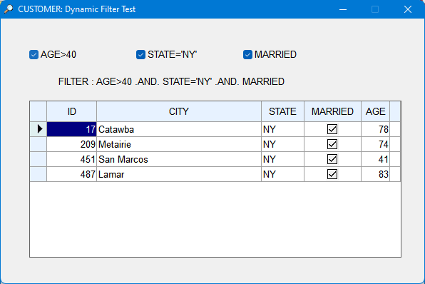

and finally add the filter on AGE field
HMG Power is ready :!:

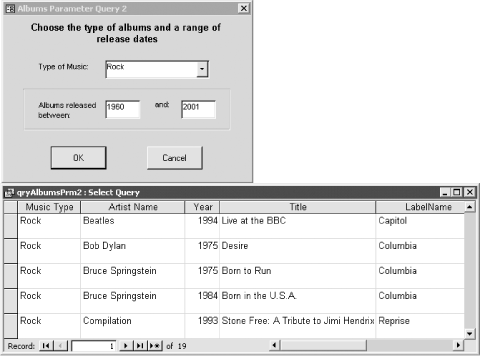

practically we need a function that dynamically create a set filter criterion (like in access on picture)

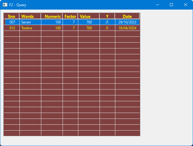

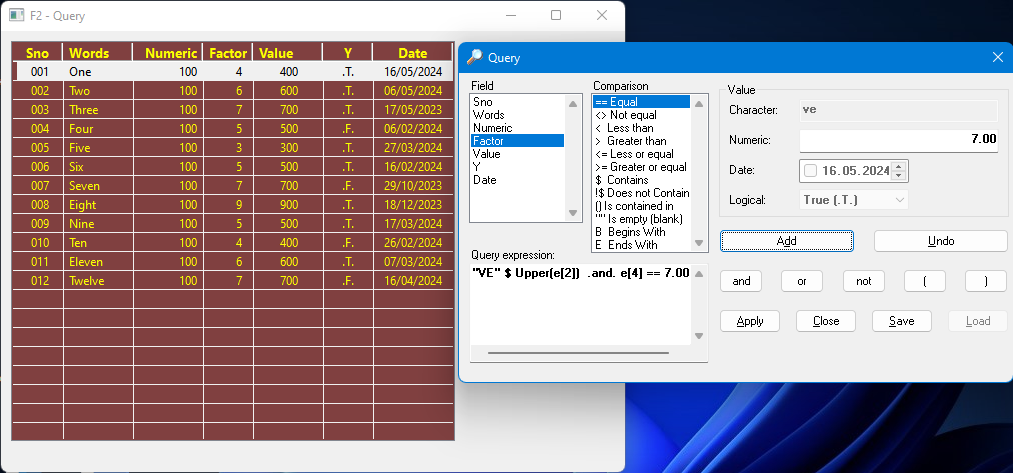

There is an example of a more advanced query dialog for any grid, as shown in the image below.
And the result of the above query is:
Here is a main form definition for testing:
