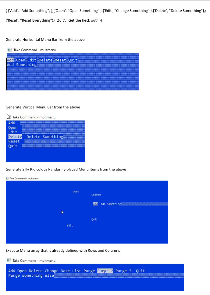

The following has zero practical use, as far as I can tell. But it was a tangent exploration thas was fun to play with.
Takes Menu Items specified in a form
{ { "First Menu item", "First Message" }, { "Second Menu item", "Second Message" }, { "Third Menu Item", "Third Message" }, etc. }
, and calculates rows and columns to generate Horizontal, Vertical, or Random menus.
Compile:
call ..\..\batch\compile.bat MultMenu /C /LE c:\minigui\Harbour\lib\hbnf /C /LE c:\minigui\Harbour\lib\SUPER %2 %3 %4 %5 %6 %7 %8 %9
#Include "MiniGui.ch"
#Include "hbinkey.ch"
#Include "inkey.ch"
Function MultMenu
Local MainMenu_a := { ;
                      {'Add', "Add Something", },;
                      {'Open', "Open Something" },;
                      {'Edit', "Change Something" },;
                      {'Delete', "Delete Something"},;
                      {'Reset', "Reset Everything"},;
                      {'Quit', "Get the heck out" }}
Local CompleteMenu_a := { ;
                      {1,1 ,  "Add",          2, 1, "Add something"},;
                      {1,5 ,  "Open",         2, 1, "Open something"},;
                      {1,10 , "Delete",       2, 1, "Delete something"},;
                      {1,17 , "Change Date",  2, 1, "Change the current Date"},;
                      {1,29 , "List",         2, 1, "Display List"},;
                      {1,34 , "Purge",        2, 1, "Purge something"},;
                      {1,40 , "Purge 2",      2, 1, "Purge something else"},;
                      {1,48 , "Purge 3",      2, 1, "Purge something one more time"},;
                      {1,57 , 'Quit',         2, 1, 'Get da heck out'}}
SETCOLOR( "W+/B,B/W,,W+/B")
cls(23, chr(177))
ComputedArray_a := Fill_in_Coordinates_for_Menu_Array( MainMenu_a, "HORIZONTALBAR" )
nSelected := Execute_MenuArray(ComputedArray_a,1,.t.)
cls()
ComputedArray_a := Fill_in_Coordinates_for_Menu_Array( MainMenu_a, "VERTICALBAR" )
cls()
ComputedArray_a := Fill_in_Coordinates_for_Menu_Array( MainMenu_a, "RANDOMMENU" )
cls()
nSelected := Execute_MenuArray(CompleteMenu_a,1,.t.)

// Menu item
AADD( HorizontalMenuItem_a, Row_n )
AADD( HorizontalMenuItem_a, Column_n )
AADD( HorizontalMenuItem_a, MenuItem_s )
// Messages associated with each Menu item
AADD( HorizontalMenuItem_a, Row_n + 1 )
AADD( HorizontalMenuItem_a, 0 )
AADD( HorizontalMenuItem_a, Message_s )
// Calculate Next Column, which will be the previous column plus the length of the current menu item plus the length of one space.
Column_n := Column_n + Len( Trim( MenuItem_s ) ) + 1
Return HorizontalMenuItem_a
Function ConvertMenu_to_VerticalBar( MenuItem_a )
  MenuItem_a has the structure
  { MenuItem, Message }
Local VerticalMenuItem_a := {}
Local Column_n := 1
Local MenuItem_s := ""
Local Message_s := ""
STATIC Row_n := 0
MenuItem_s := Trim( MenuItem_a[ 1 ] )
Message_s := Trim( MenuItem_a[ 2 ] )
// Menu item
AADD( VerticalMenuItem_a, Row_n )
AADD( VerticalMenuItem_a, Column_n )
AADD( VerticalMenuItem_a, MenuItem_s )
AADD( VerticalMenuItem_a, Column_n + Len( MenuItem_s ) + 2 )
AADD( VerticalMenuItem_a, Message_s )
// Calculate Next Row, which will be the previous Row plus 1.
Row_n := Row_n + 1
Return VerticalMenuItem_a
	Please do not ask me, why I built something as insane and useless
	 as a menu picklist located at random points on the screen.
	It just sounded like it would be fun to see.
Function ConvertMenu_to_RandomMenu( MenuItem_a )
#DEFINE TEMPORARYRANDOMROWLIMIT 15				// Maximum number of row coordinates
#DEFINE TEMPORARYRANDOMCOLUMNLIMIT 72			// Maximum number of column coordinates
/*	TODO - The maximum number of rows and columns used to extract the random rows and columns,
	 should be a factor of the total number of menu items.
Local RandomMenuItem_a := {}
Local RandomRow_n := 0
Local RandomColumn_n := 0
Local Column_n := 1
RandomRow_n := hb_RandomInt( TEMPORARYRANDOMROWLIMIT )
RandomColumn_n := hb_RandomInt( TEMPORARYRANDOMCOLUMNLIMIT )
// Menu item
AADD( RandomMenuItem_a, RandomRow_n )
AADD( RandomMenuItem_a, RandomColumn_n )
AADD( RandomMenuItem_a, MenuItem_s )
AADD( RandomMenuItem_a, RandomColumn_n + Len( MenuItem_s ) + 2 )
AADD( RandomMenuItem_a, Message_s )
Return RandomMenuItem_a
Function ConcatenateAllFirstLetters_of_Menus( ConcatenateFirstLetters_s, Menus_a, FirstValue_s )
Local FirstLettersOfMenus_s := ""
FirstLettersOfMenus_s := AReduce("ConcatenateFirstLetters",Menus_a, FirstValue_s )
Return FirstLettersOfMenus_s
[attachment=0]MultiMenu.jpg[/attachment]
