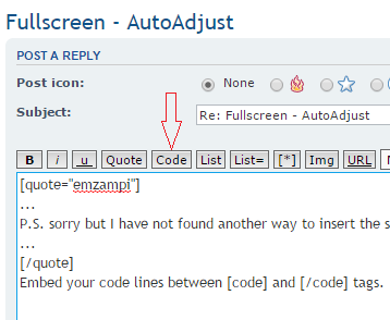

P.S. sorry but I have not found another way to insert the source file !!???

- esgici
- Posts: 4543
Re: Fullscreen - AutoAdjust
Embed your code lines between "code" and "/code" tags. "Tags" should be enclosed by brackets.emzampi wrote: ...
You can use "Code" button of post editor:
There isn't a "file insert" option; you need copy and past. You can use "attachment" option for long files.
Happy HMG'ing
