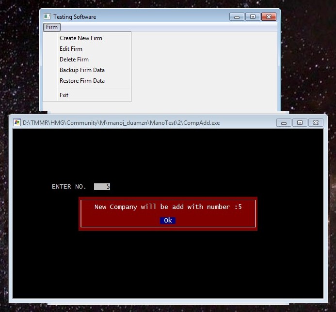

manoj_duamzn wrote:... in starting please help me for mixed application. Later target is fully GUI...
Hi Manoj
I don't know this method will help you :?
Screenshoot of Manoj mixed UI project Test 2
ManoTst2.zip
Mixed UI project of Manoj; source files
(1.16 KiB) Downloaded 425 times
Please don't hesitate to ask anything, as always :arrow:

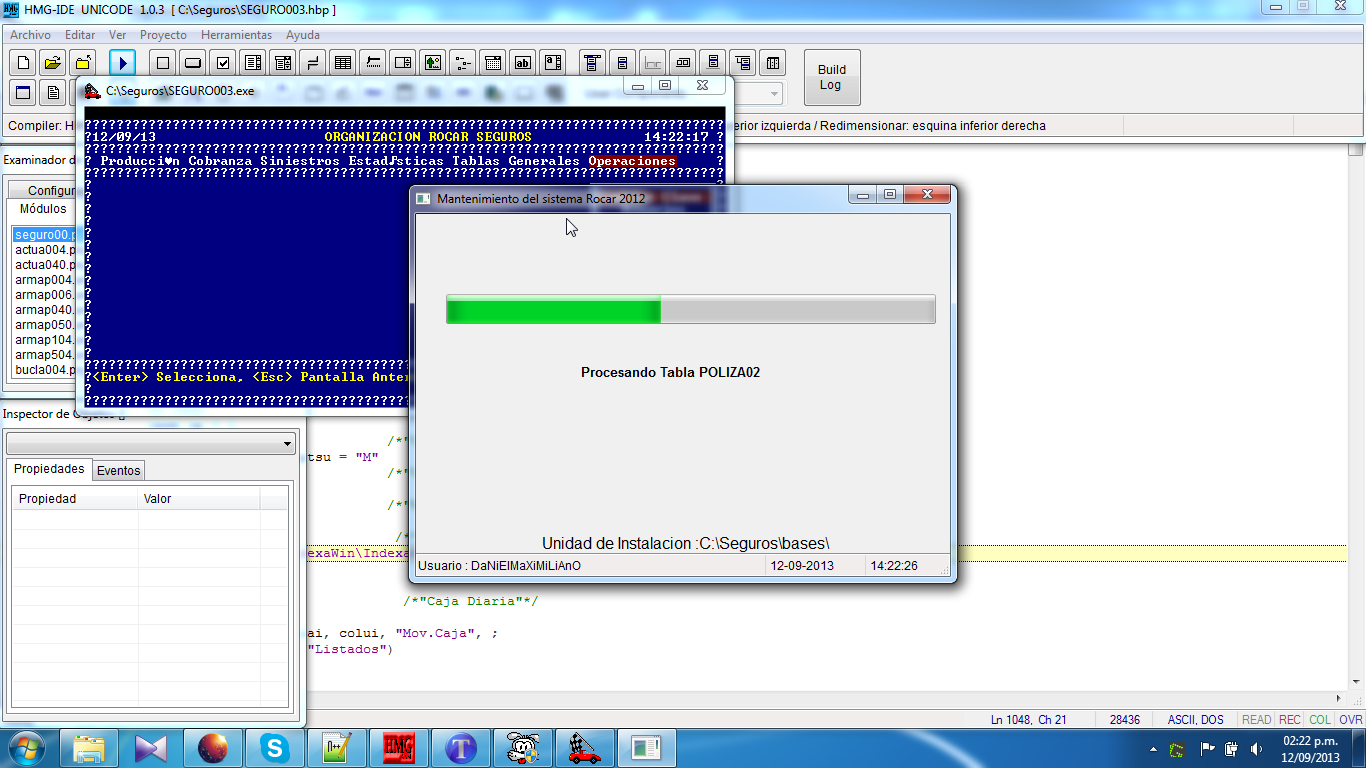

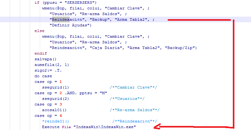

Hola Mano :
como le sugiere el amigo Esgici puede crear una aplicacion GUI que ejecute sus modulos en consola. o como hice en un momento con una vieja aplicacion, ejecutar desde consola viejos modulos convertidos a GUI.
Translate google
Hello Mano:
as Esgici friend suggests you can create a GUI application modules running your console. or as I did in a moment with an old application, run from console converted GUI old modules.
console mixed.png (231.49 KiB) Viewed 6680 times
