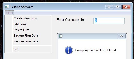

Here slightly modified version of your test project :
Screenshoot of ManoTest project
ManoTest.zip
Source ( .hbp, .prg ) of ManoTest Project
(970 Bytes) Downloaded 465 times
Definitely you don't need neither Console /Mixed mode, terminal drivers nor low-level acrobatics;
GUI always better than CUI, not only by appearance, by programming efforts too :arrow:
And HMG is wonderful 8-)
