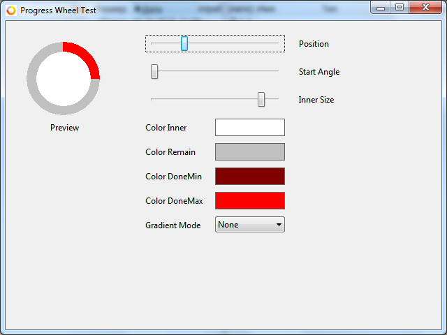

Hello All,
Please take a look for my first attempt to create a new Progress Wheel Control in HMG.
I've attached also a sample application for your review. 8-)
Your feedback is welcome :arrow:
ProgressWheel.zip
Progress Wheel Control Test
(894.95 KiB) Downloaded 187 times

Look very good and can change all properties in run time !
Great job !!!

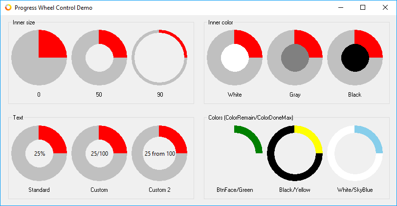

Hello Friends,
Thanks for your feedback and attention.
I've prepared an other sample application (see screen shot).
The all source code of this example is below:

It is a Harbour MiniGUI power (an above work is based on the wonderful BosTaurus library) 8-)
