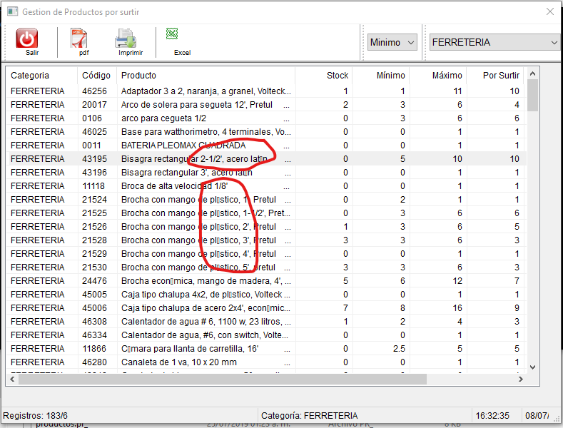

Hello everyone
I get data from a query to Mysql, but the accented words are not correct, example:
"Placa 1 m_x0003_dulo, de aluminio, l_x000D_nea Econ_x0003_mica" must be "Placa 1 módulo, de aluminio, línea Económica"
I have defined this in my program:
REQUEST HB_LANG_ES
// REQUEST HB_CODEPAGE_ESWIN
REQUEST HB_CODEPAGE_UTF8
FUNCTION Main ()
HB_CDPSELECT ("UTF8")
// HB_CDPSELECT ("ESWIN")
// HB_SETCODEPAGE ('ESWIN')
HB_LANGSELECT ('ES')
DEFINE WINDOW Main;
AT 0.0;
WIDTH 800 HEIGHT 600;
TITLE 'Product management';
MAIN;
ICON ". \ RESOURCES \ Carrito.ico";
FONT 'Arial' SIZE 10;
ON INIT ConnectTo ();
ON RELEASE My_SQL_Logout ()
and I can't find the solution, any idea about it or what I'm doing wrong.
Best regards
Jose Luis

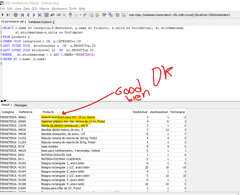

And this is the result of query:
Categoria Reference Producto StockActual stockmaximum PorComprar
FERRETERIA 10031 Abrazadera mini-6 de acero inoxidable, blister con 4 pzas 45 12 -33
FERRETERIA 44240 Abrazadera reforzada, # 28, 1-1/2 - 2-1/4', bolsa 10 pzas 30 1 -29
FERRETERIA 44243 Abrazadera reforzada, # 40, 2-1/4 - 3', bolsa 5 piezas 13 4 -9
FERRETERIA 44247 Abrazadera reforzada, # 56, 3-1/16 - 4', bolsa 5 piezas 18 1 -17
FERRETERIA 13468 aceite aflojatodo en aerosol 110 ml 5 4 -1
FERRETERIA 13471 aceite aflojatodo en aerosol 400 ml 3 4 1
FERRETERIA 16712 Aceite multiusos, 90 ml 7 10 3
FERRETERIA 46256 Adaptador 3 a 2, naranja, a granel, Volteck 1 11 10
FERRETERIA 44466 Alambre galvanizado, calibre 14.5 4 3 -1
FERRETERIA 44467 Alambre galvanizado, calibre 16 1 1 0
FERRETERIA 44468 Alambre galvanizado, calibre 18 3 3 0
FERRETERIA 0105 amarrador de varilla 1/2 3 5 2
FERRETERIA 12815 Amarrador de varillas con grip 3 1 -2
FERRETERIA 20017 Arco de solera para segueta 12', Pretul 2 6 4
FERRETERIA 10254 Arco jardinero tubular, 21' 2 1 -1
FERRETERIA 0106 arco para cegueta 1/2 0 6 6
FERRETERIA 44382 Armella 22 x 100, abierta, caja con 72 pzas 7 1 -6
FERRETERIA 44376 Armella 23 x 110, cerrada, caja con 72 pzas 48 1 -47
FERRETERIA 49902 Asiento económico para WC, 35 cm, blanco 3 1 -2
FERRETERIA 20060 Aspersor plástico dos vías, estaca de 14 cm, Pretul 4 6 2
FERRETERIA 12578 Banda de plástico 'precaución', 300 ft 3 1 -2
FERRETERIA 44030 Bandola destorcedora, de zinc, 3' 7 12 5
FERRETERIA 44038 Bandola mosquetón, de acero, 1/4' 8 1 -7
FERRETERIA 21255 Báscula romana de resorte de 100 kg, Pretul 4 4 0
FERRETERIA 21254 Báscula romana de resorte de 50 kg, Pretul 4 1 -3

- this is a Image
- Anotación 2019-08-07 163323.png (69.33 KiB) Viewed 3549 times

jlas60
- Posts: 5
- Joined: Sun Apr 16, 2017 12:29 pm
- DBs Used: DBF, MySQL, MariaDB, SQLite, FireBird, ODBC, MS sqlserver, db2
- Location: Tres Valles, Veracruz, México
Re: Query in Mysql, the accented words are not correct
Is VARCHAR(255)

jlas60
- Posts: 5
<code>
DROP TABLE IF EXISTS `products`;
CREATE TABLE `products` (
`ID` varchar(255) NOT NULL,
`REFERENCE` varchar(255) NOT NULL,
`CODE` varchar(255) NOT NULL,
`CODETYPE` varchar(255) DEFAULT NULL,
`NAME` varchar(255) NOT NULL, <------------------------ ok but in program nok

- Anotación 2019-08-09 174513.png (83.4 KiB) Viewed 3513 times

your application is writing correct to the database, what is not working would be your sample on the grid.
application:
write = ok mysql -> ok
read = nok -> hmg nok select or convert configuration error
