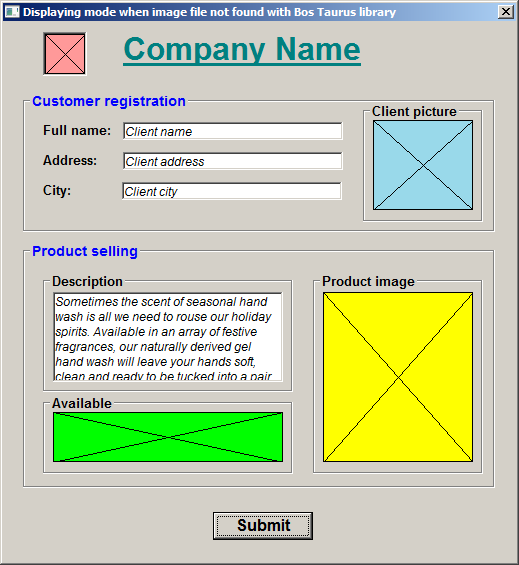

Hi All,
We can create a special image file when just start a new record and we solve the missing image. But you can make it better and like as is done in HMG IDE :!:
There is a simple way to display without any file.
Just improve your lean apps with powerous Boss Taurus resources.
In this example, are defined hmg2.bmp, hmg3.bmp and hmg4.bmp for Images controls at Demo2.fmg file. Those bmp files will not be found then not will be loaded too but it will be displayed a cross as empty image at each control image.
Here's source files to see IfNotFoundImg function and Crop images from rc files and replacement in image controls.

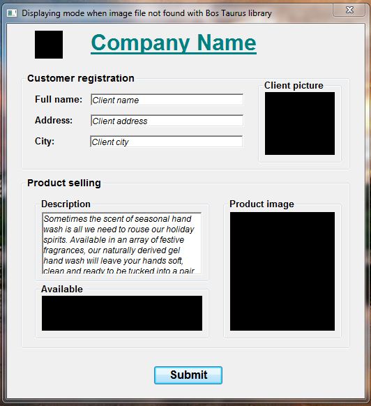

If image really not found :( :
If image really not found.JPG (58.55 KiB) Viewed 3921 times
Viva HMG :D
What displays when no image available?
esgici wrote:If image really not found :(
Submit option extacts images from rc file for images replacement. Check you rc file, should not be empty before you compile and Images must be as subfolder where exe is running.

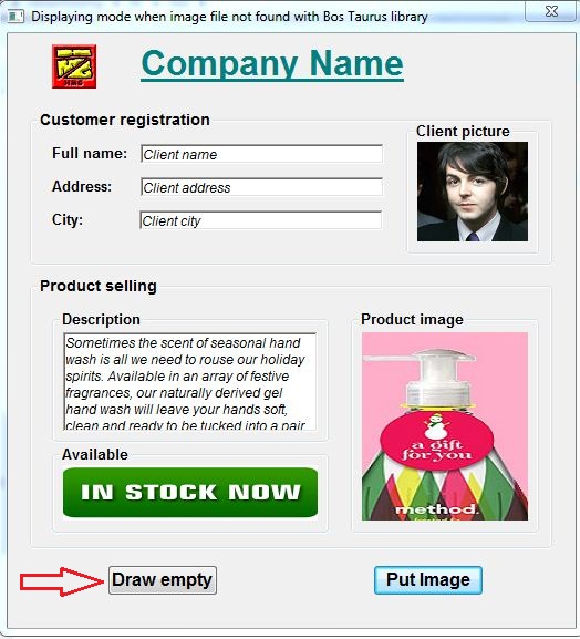

Re: What displays when no image available?
Does this is a irreversible method :?: :(
Test draw empty.JPG (101.27 KiB) Viewed 3812 times

Irreversible?
IfNotFoundImg function was created with propose to display something in place of empty image.
In my demo2, if you delete any file at Images folder you will see a cross inside image control instead of blank or non existential control by viewing. This can happen when users deletes files or when open a new register when image of client was not taken picture yet.
IfNotFoundImg function you can use it as you want and where you want at place of your app.
I do not know if I've understood what you means with your example of DrawEmpty.
In case of deleting image from the control and is this would be your case, can be solved with this:

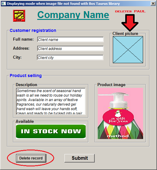

Function DeleteRecord()
SetProperty("Demo_2","Image_2","PICTURE","")  // Paul's removing
IfNotFoundImg("Demo_2","Image_2",CYAN)
Added later:
Then will be displayed empty image as cross in image control, like this:
Pablo César wrote:...
Irreversible?
I did not understood what your example with DrawEmpty means.
"Irreversible" means drawing ability on a picture assigned (and become visible) on a IMAGE control.
"DrawEmpty" attempt do this ...
More, when clicking that two button randomly and successively produce very bad results (crash prg, entirely black screen and lost of keyboard and mouse functionality.
Added later :
Please give up changing sent post :(
