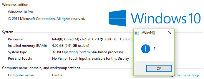

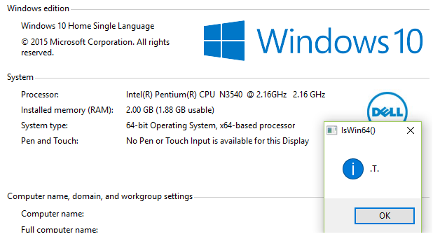

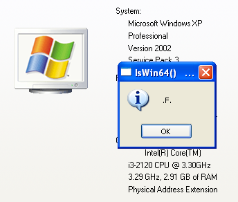

Re: IsWin64 Bit
Does someone (including author) tested for Win64 ?
Re: IsWin64 Bit
I have tested on WinXP, Win10 with 32 bit OS and 64 bit OS
Any suggestion welcome
