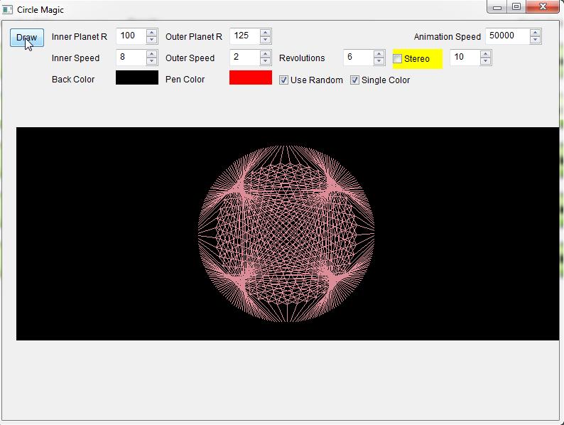

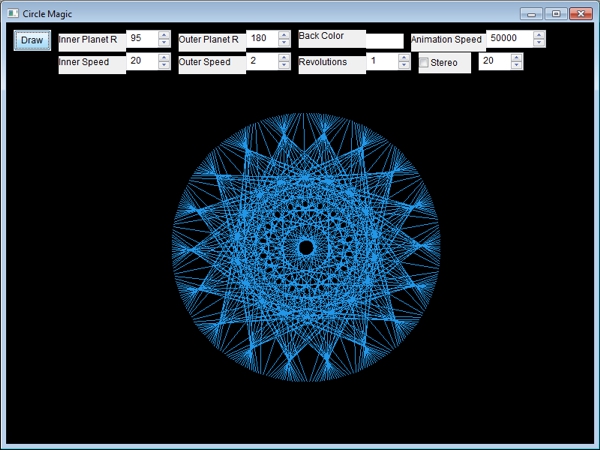

Yesterday I had seen a video to draw the relative positions of the planets Venus and Earth.
https://www.youtube.com/watch?v=_CAtiymmOaU
I wanted to do it in HMG with various parameters. The result is amazing! Hope you like it.
A request to Claudio:
Can we draw a line or other shapes transparently like the video?

Wow
It's amazing what you can do with mathematics, thanks Rathinagiri.
Posts: 3343
Re: Circle Magic
Thanks Rathi !
I like it (and fractals too !)
Posts: 5481
Re: Circle Magic
Wow! It looks great Andy! I have changed to accommodate some color options now!

Posts: 2223
Re: Circle Magic
Rathinagiri wrote: A request to Claudio:
I have a book about fractals, I'm going to search it.
The draw of this code is more efficient, because I created a bitmap that acts as double buffer.

Re: Circle Magic
Gracias Dr. Claudio, funciona OK.
Re: Circle Magic
Thank you Dr. Claudio and Mr. Rathi
