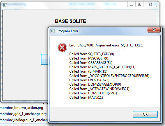

It happened to be the only lib which was "remmed out" (#) in hmg 3.3.1 (don't know why)
However, I still get following error (apparently cannot create the database)
I am using HMG 3.3.1 - 32 bits.
Should I recompile harbour or so?

Clip2Mania wrote: However, I still get following error (apparently cannot create the database)
No, it is not :?
There is a mistake in your calling the function MiscSql() - wrong a first parameter.
Please take a look for your updated module main_button_1_action.prg below:

The program will work smoothly after above update 8-)
