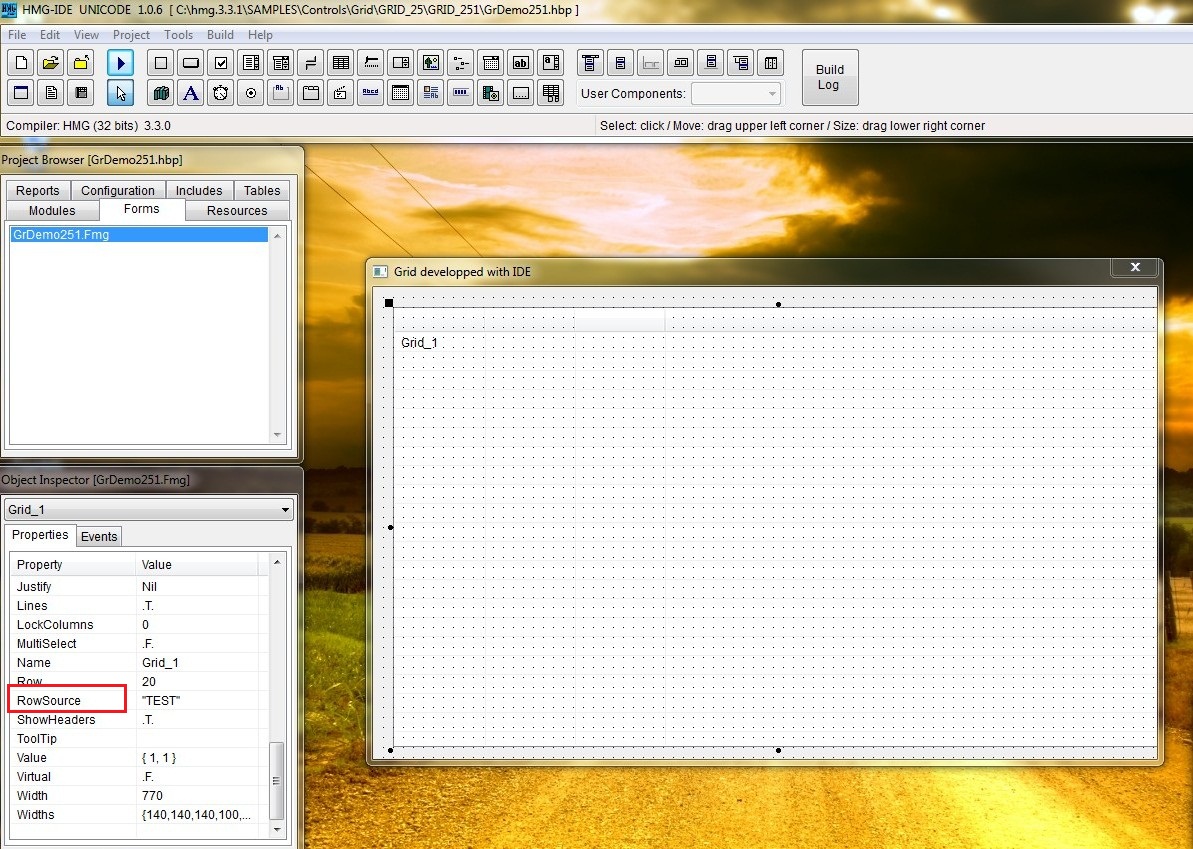

have been using Clipper for a very long time, now it is time to progress my apps to new environment. I am trying to display dbf data in grid, but i can't figure out how to connect grid with data, since in HMBG IDE there is no Rowsource (or item) property. Samples are all programmed not made with IDE.
Can anybody help me?

HMG IDE has "Rowsource" property entry ( see attached picture : GrDemo251 Form Design.jpg )

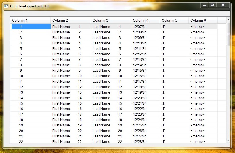

Here slightly modified version of GRID\DEMO_25 to denote defining GRID into a .fmg file.
( Menu extracted for simplify )
I hope this work responds your questions. If any problem please don't hesitate to ask, you are between friends here.
GrDemo251.zip
Grid demo 251 source and data files
(3.51 KiB) Downloaded 632 times
Grid demo 251 in action

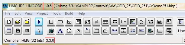

Now I understand that HMG-ID screenshot coming out when running IDE.EXE, residing within sub-dir hmg\ide.
It's funny you know... I was not aware the existance of the application. :lol: :lol: :lol:

Learning something continuously, even never ending; exciting me always; especially about HMG :D
So, a question to you Agil: what are three different version info ( marked by red rectangular ) in attached picture ( captured from above screenshot ) ?
Three different version info
