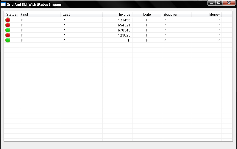

Re: GRID with image help
Hi Vagblad:
I've download your example, and my surprise becomes when i execute your exe: no readable data of the table.- I attach the screen.-
Do you have the same result.-
Thanks for your answer.-
With regards. Eduardo
- SCREEN_OF_EXAMPLE.jpg (87.98 KiB) Viewed 6665 times
Hi Eduardo,EduardoLuis wrote:Hi Vagblad:
Very strange. Try putting the Example folder inside the hmg\samples folder and run the build.bat again.
Because the .exe works fine on me.
I tested mine at the following path: C:\hmg.3.3.0\SAMPLES\Example\build.bat
Please if you can try it and tell me if it works.
Best Regards
Vag
