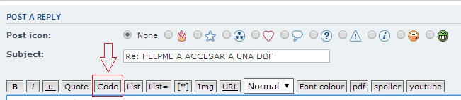

First : please properly indent and put your code between 'code' and '/code' tags by using "Code' button in the post write form. This required for easy read and easy understand your problem by your colleagues.
Code button in the post-write tool box
