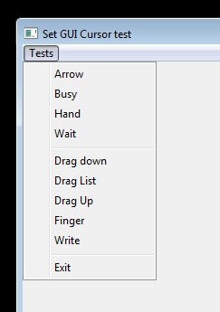

An essay to add settings some built-in Win-API cursors to standard "load from file" cursor feature of HMG.
Low-level modules and methods borrowed from MiniGUI EE; thanks to authors Jacek Kubica and Grigory Filatov.
And special thanks to my brother Mustafa for remark and recall.
Sorry Mustafa, not control specific, again form-based setting :(
Screen shoot
Screen shoot

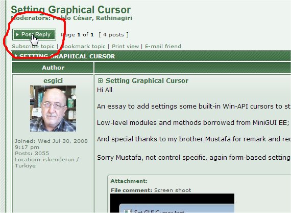

Como ejemplo en esta página web el cursor está normal
pero cuando llega el cursor sobre a Post Reply , vemos que
sale el cursor en forma de "finger", esto seria interesante
si se pudiera conseguir cuando se quiere pulsar un Boton.

As an example on this website is normally the cursor
  but when the cursor over to Post Reply, we see that
leaves the cursor in a "finger", that would be interesting
if you could get when you want to press a Button.

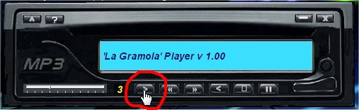

sobre el tema anterior sobre "Finger.cur" al pulsar un "Button",
les mando un antiguo ejemplo con MiniguiExtended
que documenta dicho ejemplo.

Hello
On the previous topic on "Finger.cur" when you press a "Button",
I send an old example with MiniguiExtended
documenting this example.
