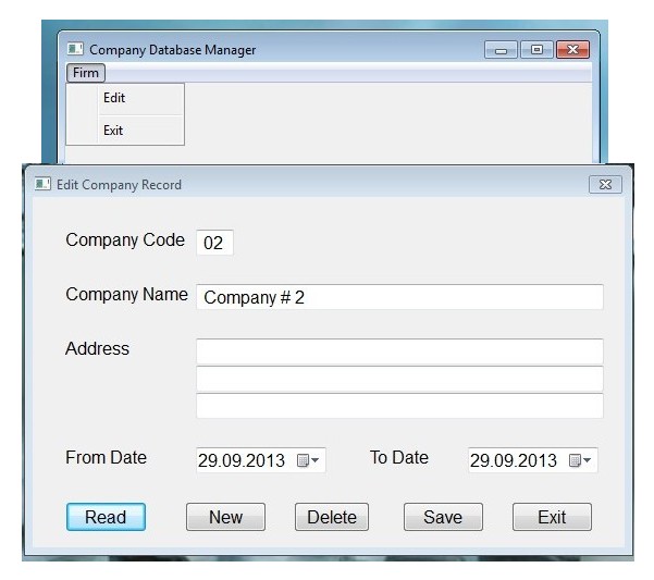

Don't be lost yourself into labirent of questions built by yourselfmanoj_duamzn wrote:...another question is depend on answer of previous question.
Attached a suggestion, not a real manager; a simple sample only :
Doesn't provide bell and whistles; only works, does its job
I hope give you an idea
Happy HMG'ing
Viva INTERNATIONAL HMG
Re: EXIT BUTTON VALIDATION
Hello,manoj_duamzn wrote:I am attaching herewith prg & dbf file as per your need.
Beside this I want to say that in previous period in clipper application I always give validation question to question and Is is required because manytimes another question is depend on answer of previous question.
It seems that you think in clipper direction hitherto however your environment was changed now
BTW you can take a look for your updated sample with implemented your needs below:
