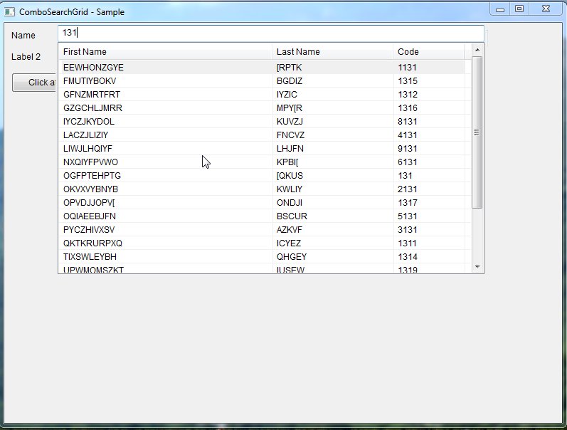

Here I am sharing my experimentation for multi-column combosearchgrid based on Esgici's ComboSearchBox. I was very much longing for a control like in MS Access with multi-column combobox. Now it is possible.
Features of ComboSearchGrid:
- I have used SQLite temporary database and table to optimize the search
- Since the combosearchgrid is based on Virtual Grid there is no limitation as to the number of rows! In the sample I have used 10000 rows. But you can check for more rows and find out how fast it is. Actually there is no program degradation because of the number of rows.
- The text is searched in all the columns.
- Anywhere search is also available
- You can show/hide the headers too.
- SQLite operations are totally hidden and you need not know anything about SQLite.
Please give your suggestions, we can make a better control!

Thanks a lot friends. I will do some enhancements like header click to sort by the column, specifying the column source from a dbf etc.
The key to the speed here is, the array is loaded to the table only once at the time of definition of the control. After that it is only a set of records from a SQLite query. The virtual grid requires only the data to be shown in the screen anytime and not the whole set.

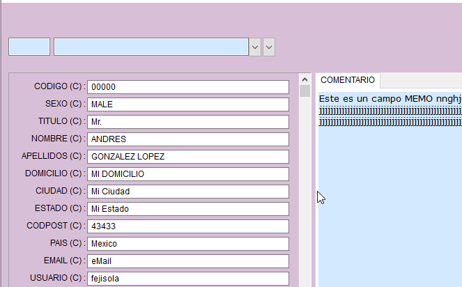

Hola a Todos :
Modifique el ejemplo para poder utilizarlo en mis aplicaciones y veo que funciona erraticamente en HMG.3.1.2
le envie este ejemplo al amigo POLO y me devuelve un ejecutable compilado en HMG.3.0.46 funcionando correctamente.
la tabla fue sacada del ejemplo Agenda...
Translate Google
Hi Everyone:
Modify the example to use it in my applications and see which works erratically in HMG.3.1.2
This example will send the friend POLO and returns a compiled executable me in HMG.3.0.46 working properly.
the table was taken from the example Agenda ...
