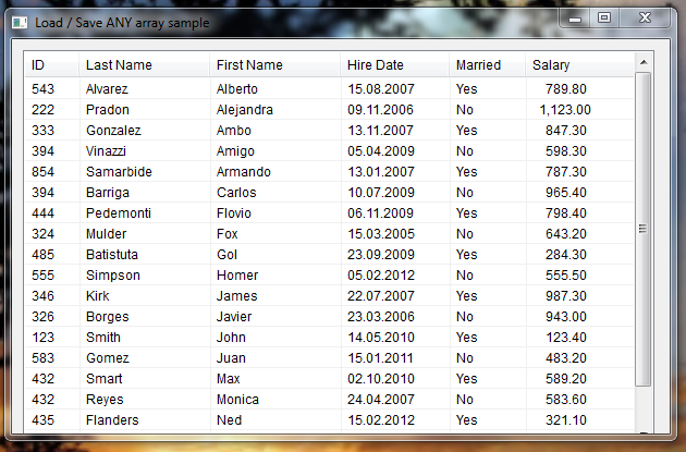

Another Load / Save array sample, this time for ANY array.
This sample load an external ANY array from a text file to the GRID and upon exit save it to the file.
For manipulating on the array into program we are using a GRID control.
All critics and suggestions are welcome.
Load / Save ANY Array sample screen shoot

Hi Rathi
rathinagiri wrote:I wish for 'CSV2Grid' and 'Grid2DBF'.
I'm a bit confused :?
Format of files built by LS2dArr and Grid2CVS is almost same;
As far as I see, only difference is string values are quoted or not (BTW, quoting is better).
And this similarity is weird : M$ Excel read but not obey column structure for both :(
What I missed ?
Please clarify, how should be format of expected / implied CSV file ?
