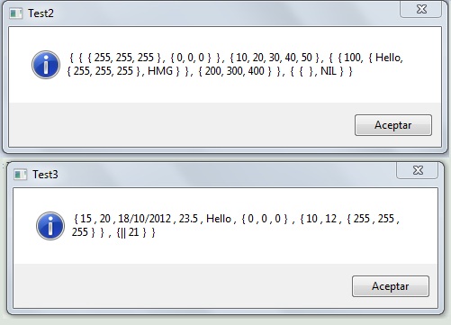

Hi all.
I developed an extended version of the MsgInfo function, is very useful for my to debug programs. This function is inspired by a similar function written by Esgici.
I hope you find it useful.
Best regards,
Claudio Soto.

   MsgInfoEx ({"Desktop Width = ", GetDesktopWidth(), "Desktop Height = ", GetDesktopHeight()}, ,"Test1", .F.)
   MsgInfoEx (aMat, ", " ,"Test2", .T.)
   MsgInfoEx ({15, 20, date(), 23.5, "Hello", aBLACK, {10,12,aWHITE}, {||10*2+1}}, " , " ,"Test3", .T.)
   MsgInfoEx ({13.9999, {|| 10 < 12}, NIL, aWHITE}, NIL ,"Test4")
