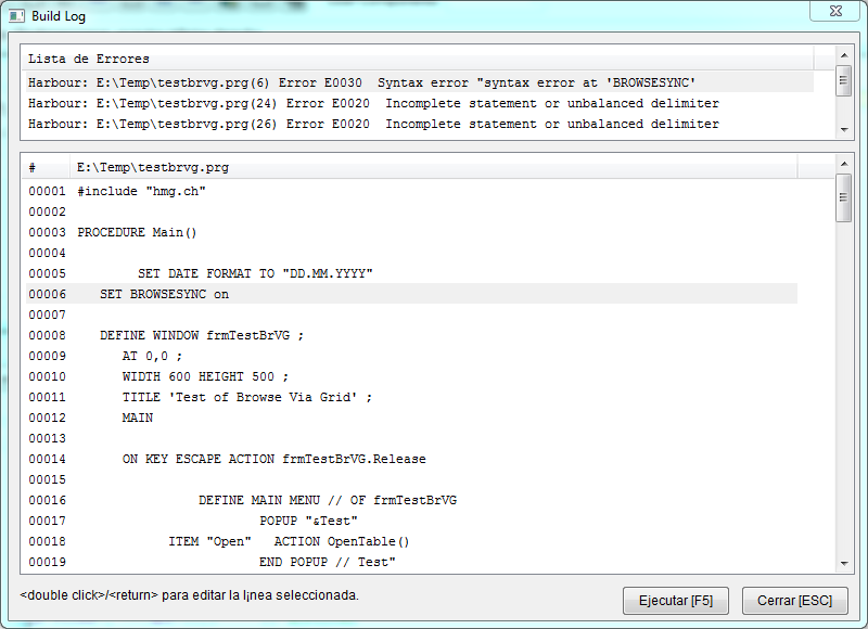

Hi :
tengo un error al compilar
Build Log_2012-01-26_13-33-37.png (61.98 KiB) Viewed 8091 times

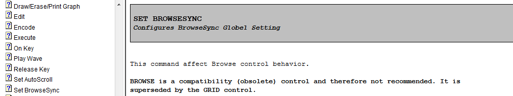

revise file:///X:/hmg.3.0.40/doc/data/index.htm
y no encuentro opciones para SET BrowseSync
HMG Reference (c)2002-2010 Roberto Lopez httpsites.google.png (16.43 KiB) Viewed 8091 times

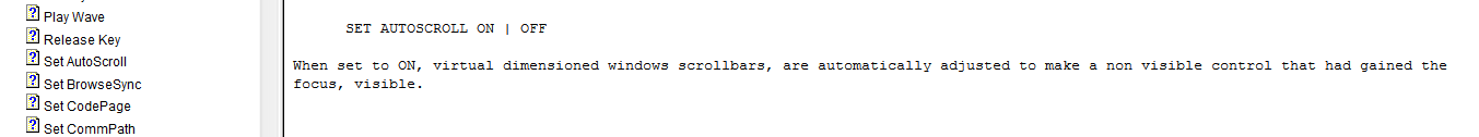

en otras opciones SET si las hay, es un error de la documentacion ???
HMG Reference (c)2002-2010 Roberto Lopez httpsites.google.1.png (12.12 KiB) Viewed 8091 times

danielmaximiliano wrote:Hi :
Google Translate wrote:I have a compile error
Here there isn't any problem 8-)
Did you tried official build.bat or HMG-IDE :?:
I guess you are using till now your handmade build process technology :?
And I'm waiting for opinions of other friends about that problem ;)
Is there anyone encountered problem of Daniel ?
At least Mol and Pablo; are you compiled without such problem ?

esgici wrote:Hola Danielo :)
I'm very happy that you are interest all my posts :D
Hello esgici:
forever discharge the examples the examples published and learn new programming methodologies, knowledge does not take place
esgici wrote: Here there isn't any problem 8-)
try using IDE version 3.0.40 and IDE4.d and the same error when compiling.
in the image detailing the error.
the build process I use is perfectly compatible with traditional build.bat only using absolute paths in my installation HMG.
