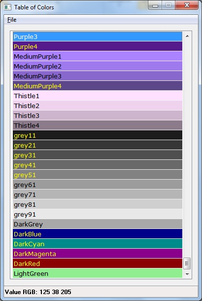

Hello,
Please take a look for the working sample below:

		DEFINE GRID Grid_1
			ROW 	12
			COL	12
			WIDTH	370
			HEIGHT	iif( IsWinXP(), 497, 504 )
			WIDTHS	{ 350 - iif(IsXPThemeActive(), 2, 0) }
			VALUE	1
			VIRTUAL .T.
			ITEMCOUNT Len(aData)
			ON QUERYDATA QueryRequest(aData)
			ON CHANGE Show_RGB()
			SHOWHEADERS .F.
			DYNAMICFORECOLOR { bColor1 }
			DYNAMICBACKCOLOR { bColor2 }
			FONTNAME "Verdana"
			FONTSIZE 10
		END GRID

Virtual Grid demo
Virtual Grid demo

Wow! It looks just great Grigory.

gfilatov wrote: Please take a look for the working sample below:
Hi Grigory,
thank you for the sample.
I ported this sample code to HMG4 syntax and it now works. Can I add it in HMG4 samples/virtualgrid directory as colors.prg ? I will keep your copyright notice, add the porting info, and probably list the changes done.
I understand this code is for minigui... does it work without changes on HMG3 ? (I don't have it installed)

mrduck wrote:...
Yes, of course. ThanKs for your attention :!:
mrduck wrote: I understand this code is for minigui... does it work without changes on HMG3 ? (I don't have it installed)
Sure (tested ;) ).
Rathi,
May be you can include this sample at the next build 3.0.40 at the folder samples\COLORS.TABLE :?:
