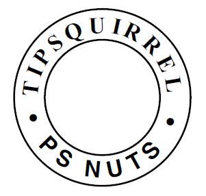

Edward, how to get following result

Do you mean something like this ?:
Bez tytułu1.png (14.83 KiB) Viewed 5231 times
Replace the HPDF_CircleText function with this one (by the way, I corrected the rims color error if the color was not defined.):

Replace #xcommand @ <Row>, <Col> HPDFPRINT CIRCLED TEXT with this one:
#xcommand @ <Row> , <Col> HPDFPRINT CIRCLED TEXT <cText> ;
	[ <lfont : FONT> <cFontName> ] ;
	[ <lsize : SIZE> <nFontSize> ] ;
	[ <bold : BOLD> [ IF <lBold> ] ] ;
	[ <italic : ITALIC> [ IF <lItalic> ] ] ;
	[ <lcolor : COLOR> <aColor> ] ;
 	[ <lrad : RADIUS> <nRad> ] ;
	[ <lrims: RIMS> ] ;
	[ <align : TOP, BOTTOM> ] ;
	HPDF_CircleText ( <Row> , <Col> , <cFontName> , <nFontSize> , <aColor>\[1\] , <aColor>\[2\] , <aColor>\[3\] , <cText> ,;
		<.bold.> .AND. iif( HB_IsLogical(<lBold>), <lBold>, HB_IsNil(<lBold>) ) ,;
		<.italic.> .AND. iif( HB_IsLogical(<lItalic>), <lItalic>, HB_IsNil(<lItalic>) ) ,;
		<.lcolor.> , <.lfont.> , <.lsize.> , <nRad> , <.lrims.> , <"align">)
In your source, use the commands:
@ 230 , 160 HPDFPRINT CIRCLED TEXT "TIPSQUIRREL" FONT "Times" SIZE 20 BOLD RADIUS 20 RIMS TOP
@ 230 , 160 HPDFPRINT CIRCLED TEXT "  "+chr(149)+"  PS NUTS  "+chr(149)+"  " SIZE 20 BOLD RADIUS 20 BOTTOM
where:
TOP - prints the text in the upper half of the circle
BOTTOM - prints the text in the bottom half of the circle
Edward.

WOW!
Thank you Edward, now we can play 360 degree

Hi Edward:
Again: WOOOOOOWWWWWWW
Excellent.- With these new functions PDF get all the possible power.-
Thanks for your effort.-
