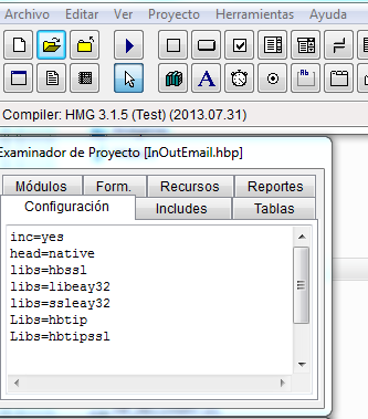

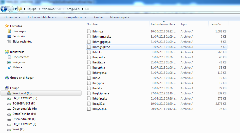

utilize este HMG.HBC y reconstruya las librerias / Use this HMG.HBC and rebuild the libraries

I think this is what you need

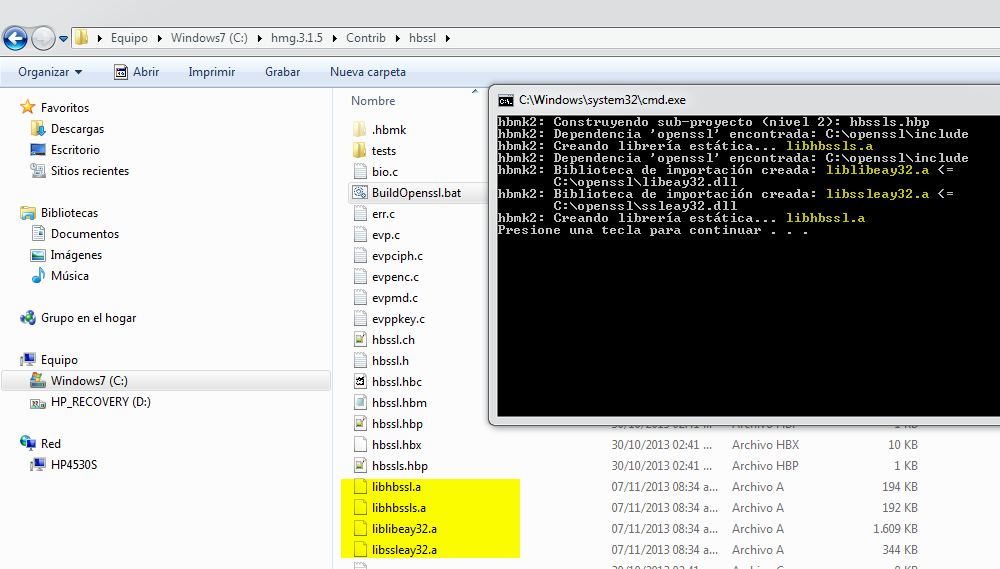

Try this.
Download OpenSSL Win32 from http://slproweb.com/download/Win32OpenS ... 1_0_1e.exe
Download OpenSSL Win64 from http://slproweb.com/download/Win64OpenS ... 1_0_1e.exe
Install to c:\openssl
Download Harbour Contrib hbssl o use harbour sources in c:\harbour\core\contrib\hbssl
Contrib.rar
(145.4 KiB) Downloaded 335 times
Execute BuildOpenssl.bat and generate library

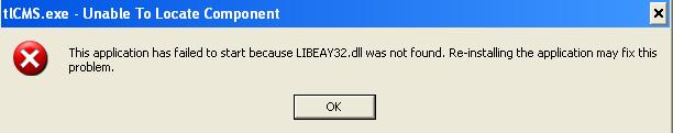

Thank you very much I'll try this. Linking the libsqlcipher gives me the error below if I don't include libeay32.dll. :)

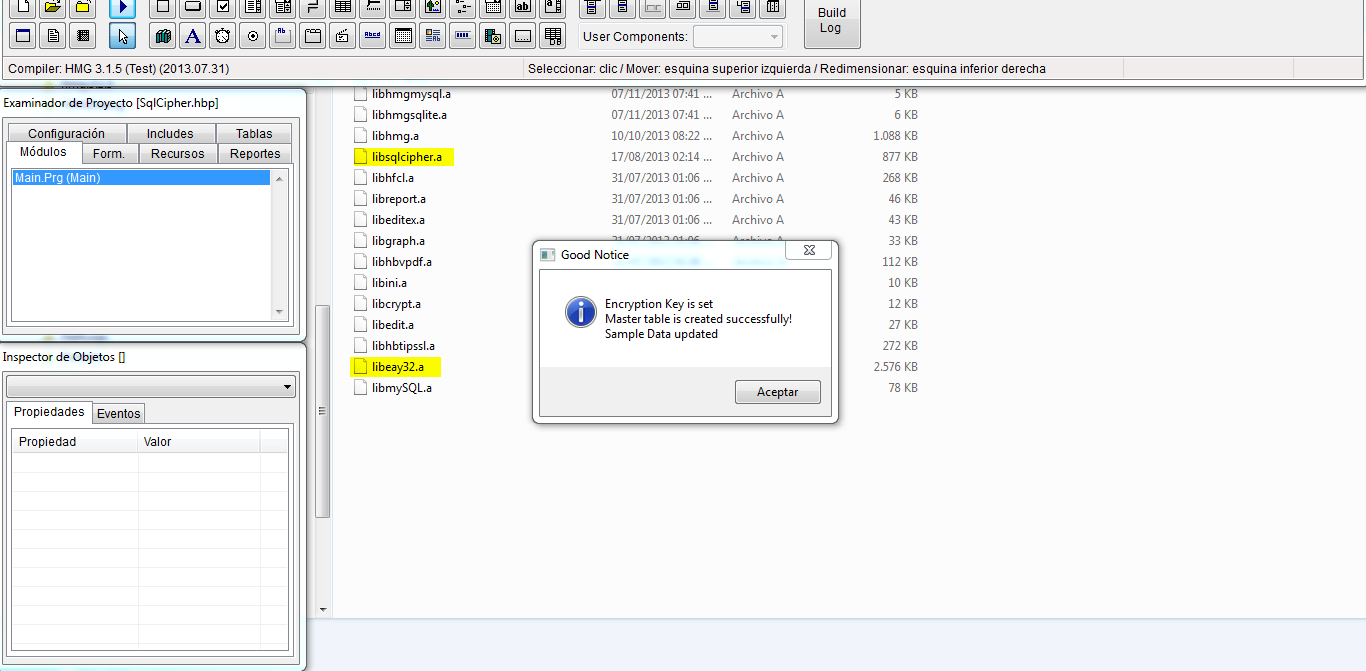

Hi Rathinagiri :
in my settings your example SQLCipher works correctly

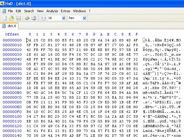

Attached is a hex view of an encrypted SQLite database.

Hi Danny,
What Hex view prg you are using ?
