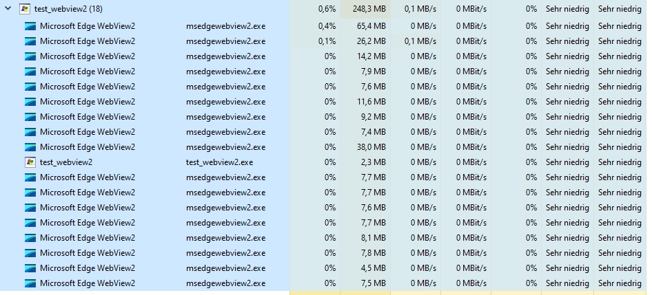

Posts: 2096
Re: HMG with Edge WebView2
after "navigate" to some Website i saw this in Taskmanager
so how to "release" all those Connection :idea:

AUGE_OHR wrote: Fri Aug 20, 2021 8:24 am Many_WV2.jpg
i recognize that EDGE Browse does same ... so it is normal.

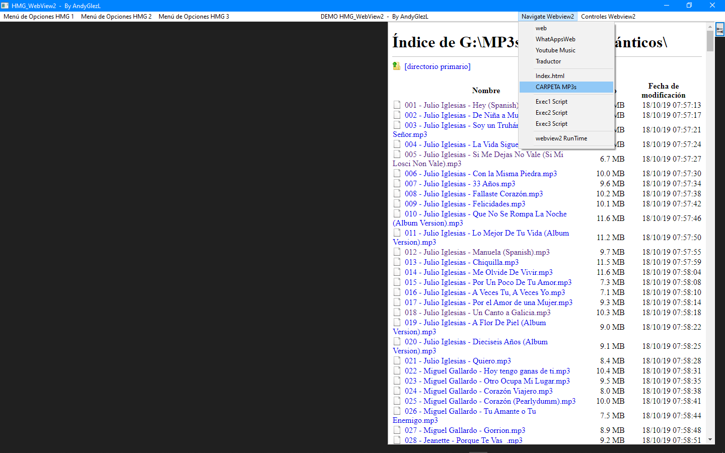

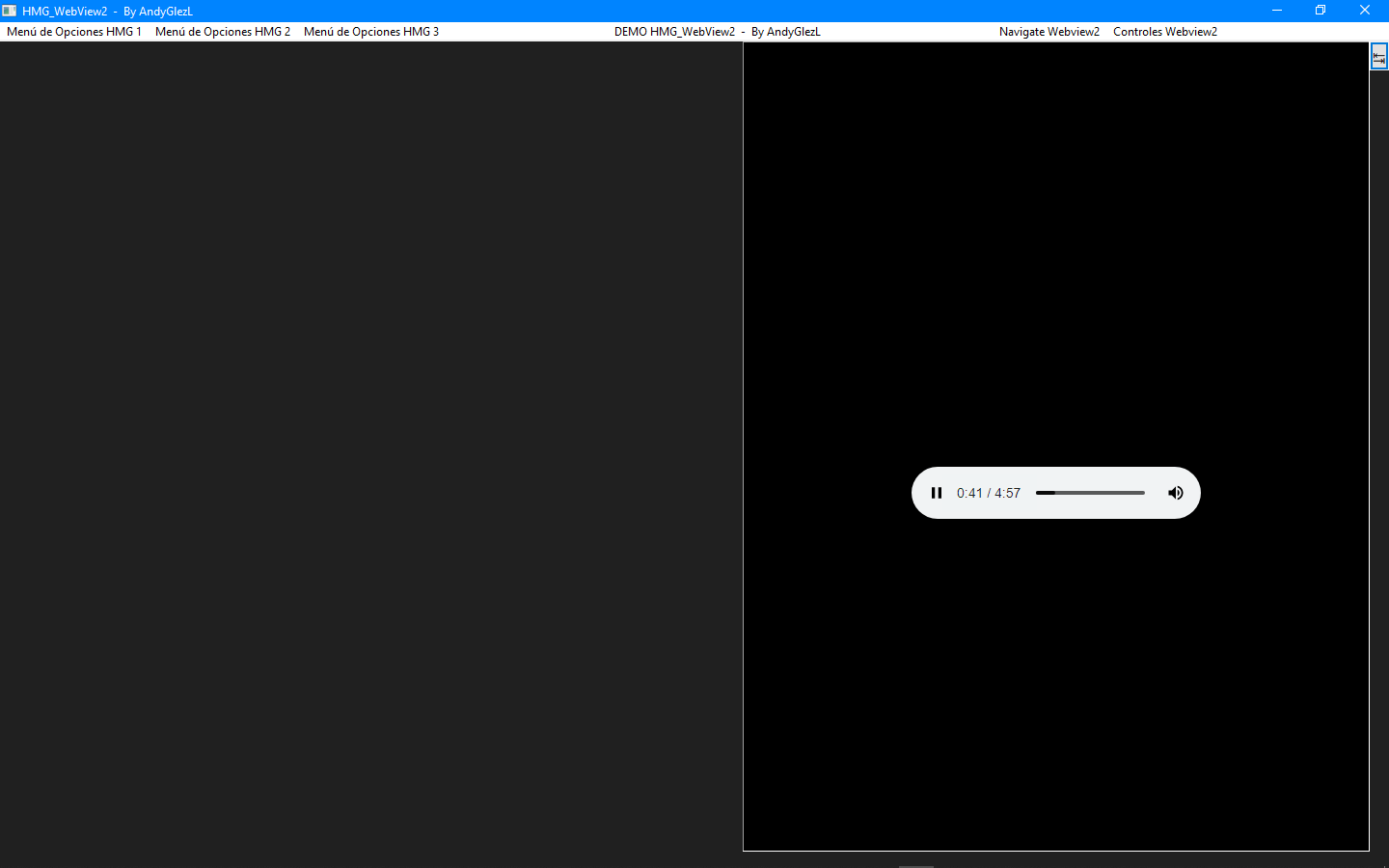

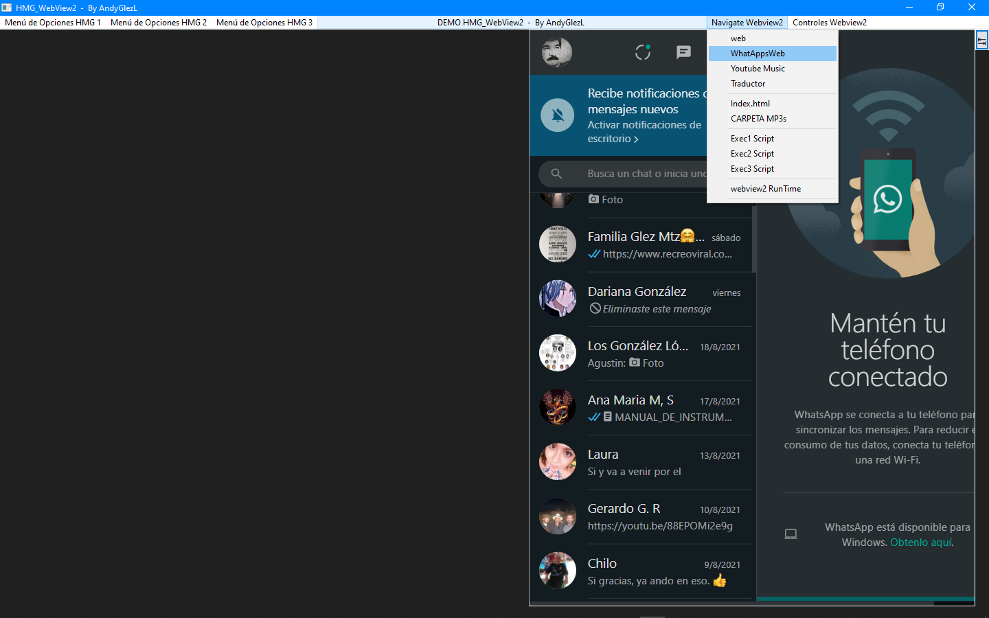

Hola a todos
He estado "jugando" con esta opción que nos ha dejado el Dr. Soto
y veo grandes posibilidades de hacer muchas cosas.
Aquí les dejo una "Demo", que la disfruten !
P.D. Recuerden modificar el archivo Build_cpp.bat con el Path
donde tengan HMG 3.5
Hi everyone
I have been "playing" with this option that Dr. Soto has left us
and I see great possibilities to do many things.
Here he left you a "Demo", enjoy it!
P.S. Remember to modify the Build_cpp.bat file with the Path
where they have HMG 3.5
Hmg-Webview2.zip
(2.12 MiB) Downloaded 447 times
