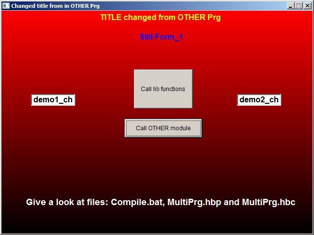

Fixed and enhanced SAMPLES
Hi Rathinagiri,
I have improved a little bit this C:\hmg.3.4.3\SAMPLES\Basics\MULTIPRG
I saw empty .ch files, both prgs in lib sub-folders were without any call function (without any use) :|
To give better idea of lib contructions and utility I've changed. Also adapted to .hbc file for libpaths and libs names.
Users can easily see this example with more utility. If you considered good for updating for next HMG release, please I gratefuly thank you.
multiprg_Exe.rar
(1.24 MiB) Downloaded 347 times
MULTIPRG.rar
(8.55 KiB) Downloaded 357 times

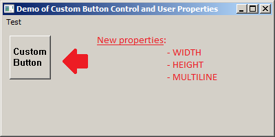

Hi Rathi and all,
Example C:\hmg.3.4.3\SAMPLES\Advanced\USER_COMPONENTS has been giving compilation error for long time. (Related by users on several occasions).
In this message I posted, it gives a hint to eliminate the error.
But reviewing the best logic and right using of two directives files for the user to make new USER components (files: i_UsrSOOP.ch and i_UsrInit.ch, included at Minigui.ch), now I have better suggestion and better results.
Please see in attached USER_COMPONENTS with 2 examples (new user control and new user command):
Custom Button
Custom Button
New User command:<br />SET LEFTJUSTIFY OF &lt;Form_Name&gt; CHECKBOX &lt;Check_Name&gt;
New User command:
SET LEFTJUSTIFY OF <Form_Name> CHECKBOX <Check_Name>
Attached is the file for your evaluation:
<Attached files -0 2 Demos, were removed because there is a newest version more ahead in this same topic.>
You will also need to rectify the "i_UsrSOOP.ch" file that is in <HMG_Root_Folder>\include folder which should have the following content:
#xcommand DECLARE CUSTOM COMPONENTS <Window> ;
#define BASE_USER_DEF ;;
#xtranslate <Window>.Print                       => PRINTWINDOW ( <"Window"> ) ;;
#xtranslate <Window>.Print()                     => PRINTWINDOW ( <"Window">, .T. ) ;;
#xtranslate <Window>.\<Control\>.Disable         => SetProperty ( <"Window">, \<"Control"\> , "Enabled", .F. ) ;;
#xtranslate <Window>.\<Control\>.Enable          => SetProperty ( <"Window">, \<"Control"\> , "Enabled", .T. ) ;;
#xtranslate <Window>.\<Control\>.Handle := \<v\> => SetProperty ( <"Window">, \<"Control"\> , "Handle", \<v\> ) ;;
#undef BASE_USER_DEF
All files in USER_COMPONENTS folder, have been changed.
  • The last xtranslate line for Handle changing, it's only used and valid for user-controls ONLY.
    HMG's controls not. Was considered according Roberto's sample at that time.
  • Two "Print" form was improved. One withou parentese that prints directly to printer defaul and Print() with parenthese for Print PreView option.
  • Enable/Disabled was due assigned as SetProperty "Enabled" true/false.
  • First menu item was changed from SetFocus to Visible property, which I considered more useful.
  • FontColor trying to be fixed with Claudio's helps.
  • User Button with new properties: WIDTH, HEIGHT and MULTILINE.
There is an unsuful and in duplicity i_UsrSOOP.ch file at CD:\hmg.3.4.3\hfcl folder. Could you please confirm for deleting at next HMG versions?
I would like to know if this example and the previous two messages satisfiy you and would be made available in the next HMG release. Could you confirm please.
Hi Claudio,
In this first example (Demo1), I tried to change the button style to BS_OWNERDRAW and I tried to change the button event function by adding the functions and they are like comment. I was not successful to adapt it. :(
Could you help me with this code ?
Solved this style, we could have a button that can change the FontColor of Caption. :P
