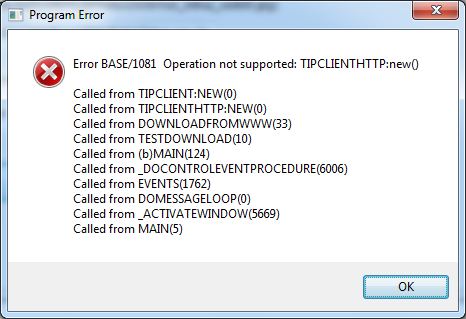

Following is the screen shot of the error
Error - Download - mol.png (32.64 KiB) Viewed 8187 times
I put following url in window
https://www.nseindia.com/content/histor ... av.csv.zip
and save to was a.zip filename, when I click the download button I got above error message.
Thanks
