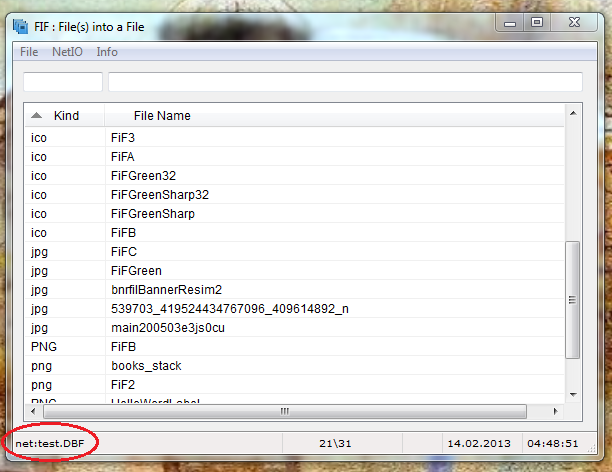

Hi all
Finally, this is new version of FiF with NetIO support.
Working, :)
but with tons of imperfection :(
Screen shoot of FiF 2013-02-14
FIF_130214.zip
Source file of FiF 2013-02-14
(16.26 KiB) Downloaded 535 times
