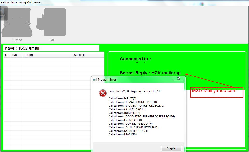

Hi, thanks for the report. into my Yahoo box and I found the same problem.
Yahoo Incomming Mail Server _2012-11-12_23-26-26.jpg (78.98 KiB) Viewed 6914 times
the method :retrieveAll( lDeleteEmailToServidor ) may have a problem
I will try another method :top( nMail ) and go individualemente messages on the server and webmail to 25 emails
and scroll through messages individualemente

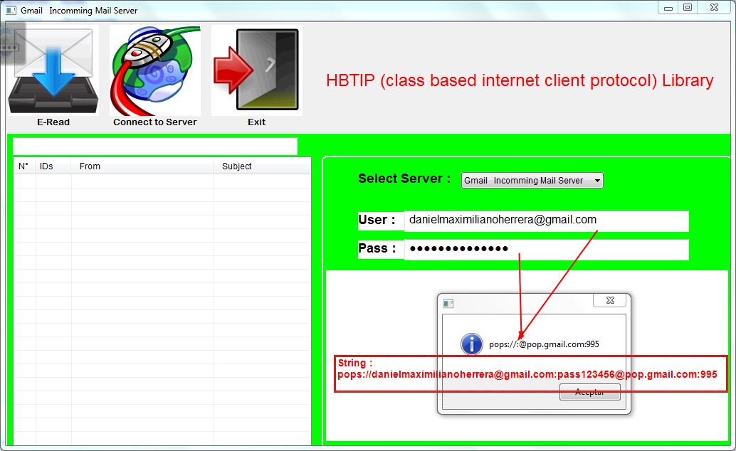

Hola Paimar, hola a todos :
Revisando y modificando la aplicacion me encontre que no conecta con el servidor, cambie tURL() por cUrl y el armado de la cadena de conexión pero al intentar conectarse de nuevo da error de Timeout o Baduser/pass
agregue al codigo Msginfo() para ver que pasa con la cadena de conexion y veo que falta user y pass, estos valores estan en blanco.
algo pasa que el valor de Incomming.cUser y Incomming.cPass pierde el valor, intentando varias veces con el Botton Connect Server estos 2 controles pasan el valor cUser y cPass
Google Translate
PAIMAR Hello, hello all:
Reviewing and modifying the application I found that does not connect to the server, change Turl () by Curl and the assembly of the connection string but when trying to connect again gives Timeout error or Baduser/pass.
add the code MsgInfo() to see what happens with the connection string and see that lack user and pass these values ​​are blank.
something happens to the value of Incomming.cPass Incomming.cUser and loses the value, trying several times with the Connect Server Botton these 2 controls and pass the value CUser cPass :?
Any Idea :?:
