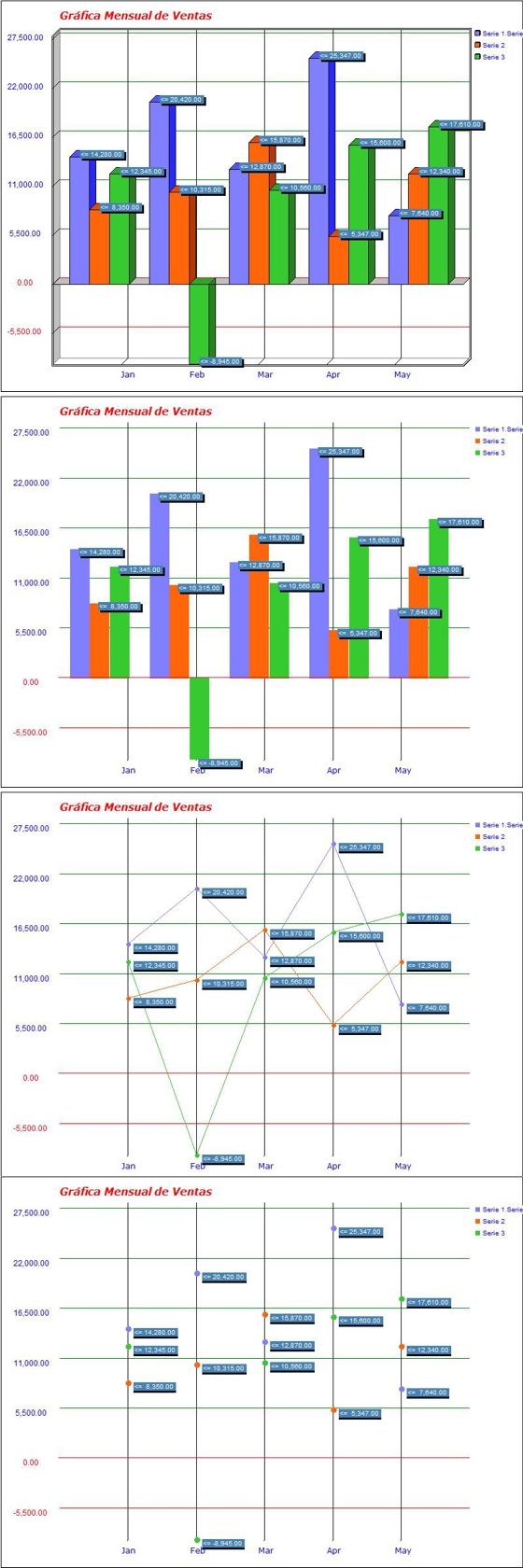

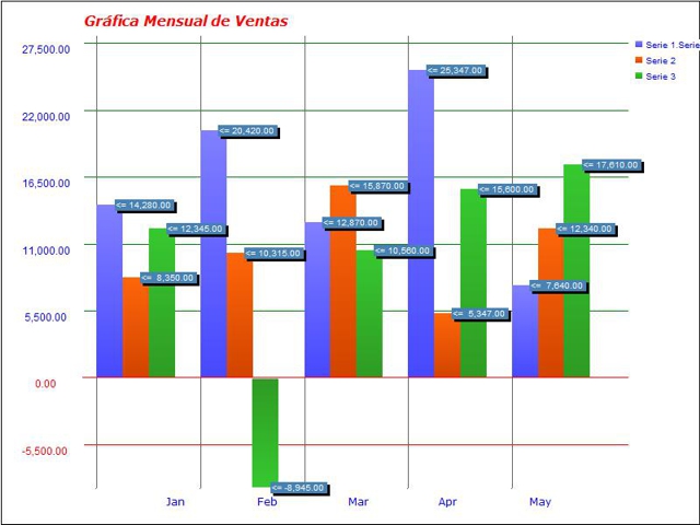

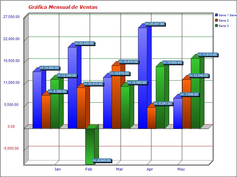

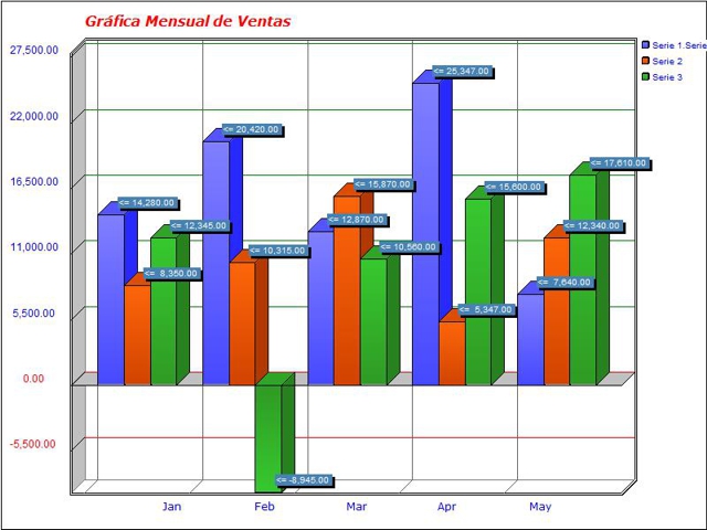

Andy, I have modified the code to place the Values on the bar. But I don't know whether this will look good for all the other values/series.

Re: HMG Graph based on Bas Taurus
Hello Rathi, thanks, It seems to remain correct in different types.
They are wanting only the vertical lines of the grid, to correspond to each
green bar. (sorry for abusing your time). Thank you
O tal vez, disminuir el espacio entre cada 3 barras, para que queden
dentro de la cuadricula...
Or maybe decrease the space between each 3-bar, so they are
within the grid ...
Hola
Modifiqué esta Funcion para que se vea con degradado el frente de la barra
por si lo quieren integrar al gran trabajo que hizo Rathinagiri.
Hello
I modified this function to display the gradient bar front
in case you want to integrate the great job you did Rathinagiri.

Posts: 5481
That is so cool and natural Andy! Wonderful job.
Just now I had seen your post to align the vertical lines to the green bars. I will work on it.
Thank you!
Posts: 5481
Andy,
Please try this...
Now the Grid is aligned to the Blue bar as it works in 3D also.
