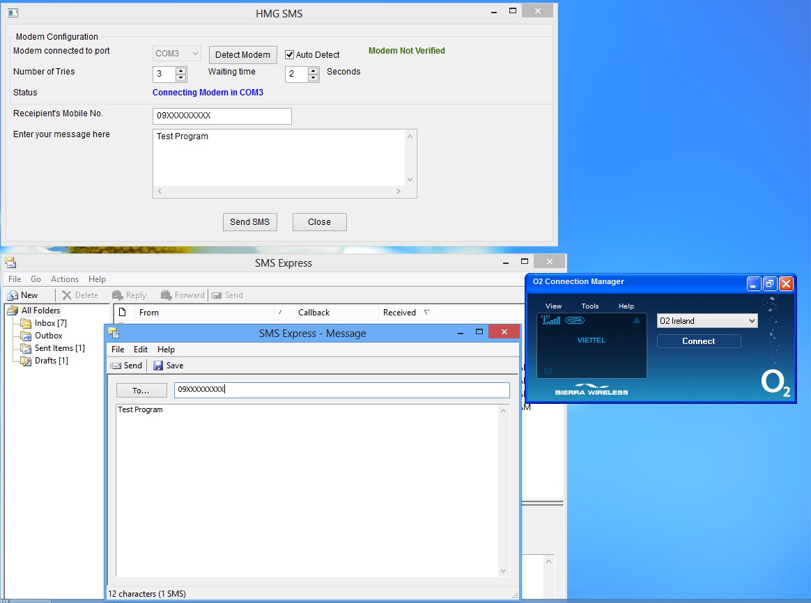

I use SMS EXPRESS, It is program integrated with auto install Dcom 3G. It is fine when I send sms from PC to mobile
But HMG SMS does't run. It does't detect modem.
I don't know how to repair

Thank you RATHINAGIRI!
HMG SMS run
My PC is Win 8
I check port in Device Manager => Ports and set port for modem
