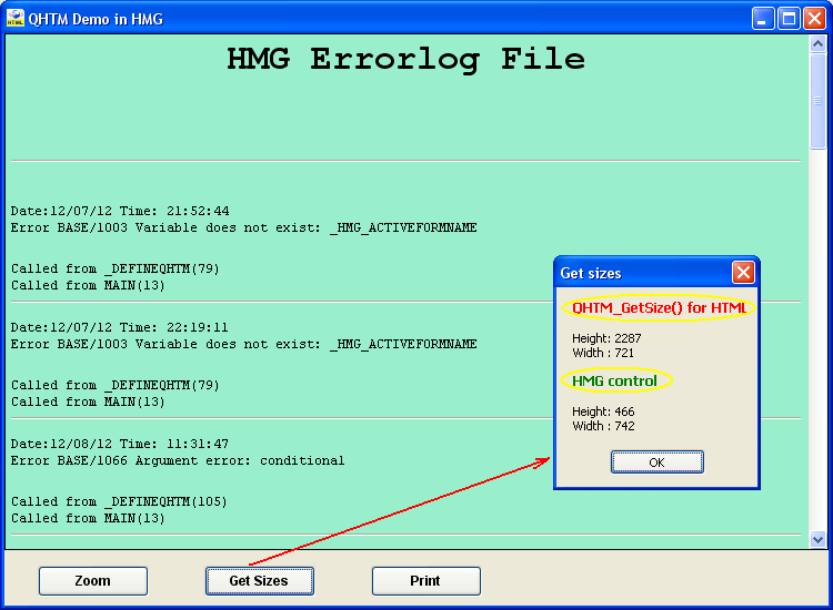

Now Zoom and fonts handling it is possible. Thanks to our friend Claudio Soto. I releasing a new version with provisory printing option, because I am still founding much difficulties to implement QHTM function for printing.

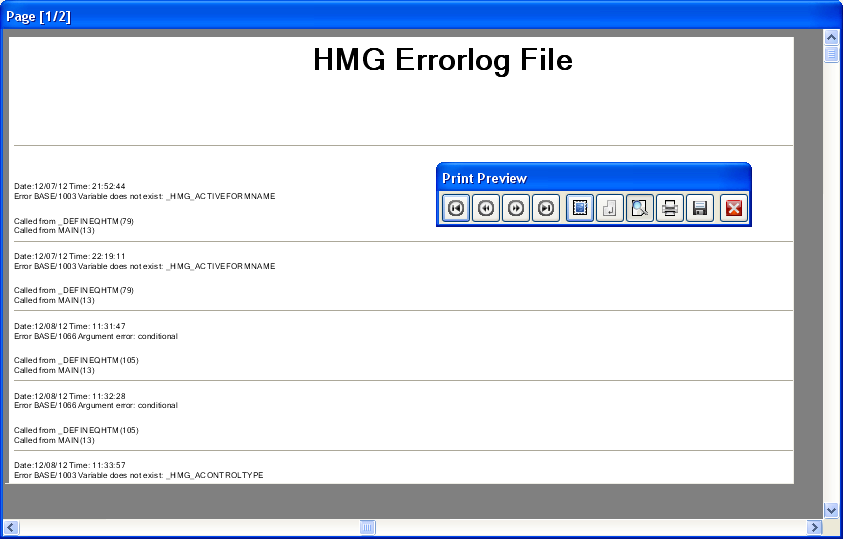

I am close. It has called Preview (two pages and it is in according with my html file) but... in blank... :cry: :x

I GOT IT !!!
Now Preview it is working with QHTM !! Nothing wrong with our MINIPRINT !
It was a second handle needed.
I also got to change backcolor thru html commands.
Also changed font color of QHTM_MessageBox (It is like our MsgInfo).
